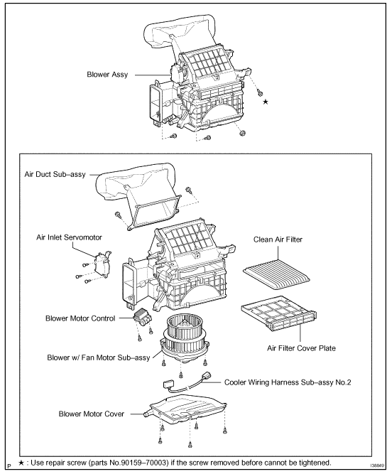

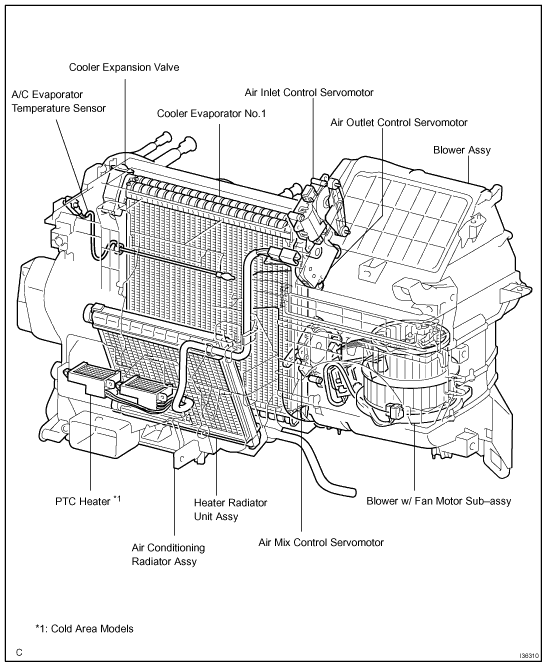

    I wish I had taken photos before I sold the Prius. I drilled a pilot hole about 2.5 inches in from the firewall. I had a fiber optic inspection scope from work that I could borrow, made sure I wouldn't drill into the e-coil.
    Then drilled the 1/2 hole. I chose 1/2 because electrical knockout plugs are that size, so very easy to close when done. Sprayed in the NuCalgon EvapFresh, problem solved
    Here are some shop manual drawings of the Prius HVAC
    Yep, most of the stuff is just powerful perfume that temporarily masks the mildew smell. You also have to be careful to use a product that is compatible/safe with the material the e-coil is constructed with
    As an example, it would be tempting to use laundry bleach to "clean" the coil. Sodium hypochlorite will absolutely kill any mold/mildew in the e-coil. It will also destroy the aluminum fins and copper tubing of the e-coil
    I would be willing to give this a try since I still have the product....2 cans....actually thought it seemed the best plan when reading your post. Based on the 1st diagram did you drill about 2.5" out from the firewall into the casing...left side of assembly towards driver side? I am trying to be certain as I want to be sure I am able to spray into coil ...and not drill into coil

    That is correct, the e-coil is up against the firewall side, the heater core is at an angle towards the passenger cabin
    Obviously, there is risk involved in drilling into the housing. Hitting the heater core will result in an expensive repair bill, hitting the e-coil will result in a VERY expensive repair bill
