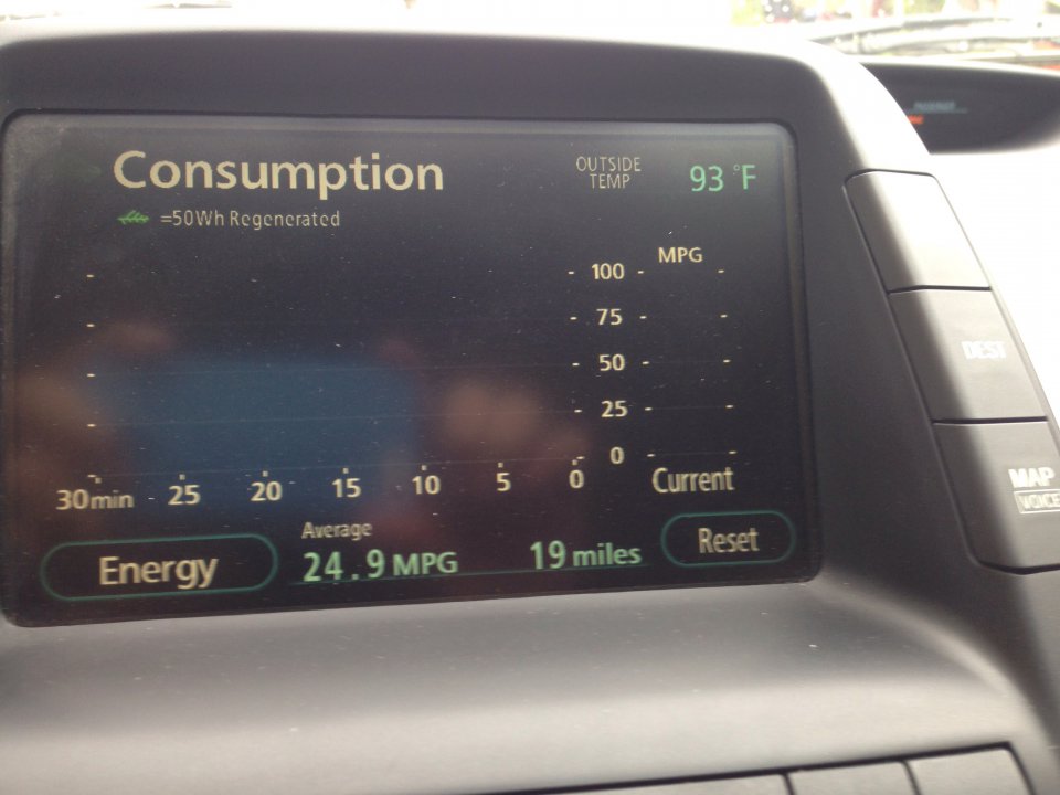

    I just got my Prius and made the test drive around the city. On my consumption screen, within 19 miles, I get only 24.9 MPG.
    Does this normal for short distance driving? I heard some people got 40+ MPG or 50+ MPG.
    Do I have to make longer drive in order to see the impact?

    Sanlen – Judging from the snapshot of the GEN 2 Consumption Screen, it is likely that the 24.9 MPG displayed is accurate for the short 19-miles distance traveled after you did the Trip Reset. I am guessing that the trend of the 24.9 number was slowly increasing towards higher MPG numbers.
    I see that the indicated outside air temperature is 93°F, and that your driving technique has generated no “Green Cars (=50Wh Regenerated).” The 93°F tells me you are likely running at Full Air Conditioning, which is a fuel economy “Hit” to your running MPG. The absence of you regenerating “Green Cars” during your 19-miles of driving tells me you likely are not driving “Hybrid $mart,” indicating you are getting no or very little positive contribution to your MPG from the Hybrid Synergy Drive (HSD) of the Prius.

    I agree not to worry about that initial number. The conditions probably weren't ideal and the driving trips were probably too short. It usually takes trips of at least 30 minutes to get into the 45+ mpg averages. There are so many variables. Route is a big one. Some routes are very difficult to obtain high mpg averages on. Other routes are ideal for high mpg.
    I have one disagreement with an earlier post, mentioning that you weren't regenerating enough energy (although it looks like you haven't driven 5 minutes yet--there are no 5-minute bars for the green cars to appear in). I believe it's best to minimize the amount of regeneration, due to the losses in the regen-electric drive loop. Some regeneration is normal and unavoidable but you want to minimize it. For example, if you drive down a city street, brake to a stop every 50 feet and then accelerate again, you'll be regenerating more energy than if you drove down the same street at a constant speed, but your mpg average will be much lower. It's better to conserve momentum than regenerate lots of energy.

    If those 19 miles were at 75mph then that 24.9 might be legit, I'd suggest restarting the trip meter and driving 20 miles at 20-30mph, not going from stop sign to stop sign but cruising around and see what the numbers are.
    Just drive the speed limit, get quickly to speed and coast up to stops, pump the tires up to 40 and enjoy.

    Take a long drive on level terrain, ~50 mph speed, and see what mpg is logged. It should be in the 40 mpg range or better. Take a photo of the multifunction display when it shows the histogram of bars displaying mpg attained over the most recent 30 minutes of driving.

    This is the 2007 Prius was exported from US to Cambodia last month. There were no major accident as per its VIN number and base on VIN, this car was well maintained by the previous owner. Its current mileage is 100582 now. Parts which i have replaced are: Engine Air Filter, Cabin Air Filter, Engine & Transmission Fluid.
