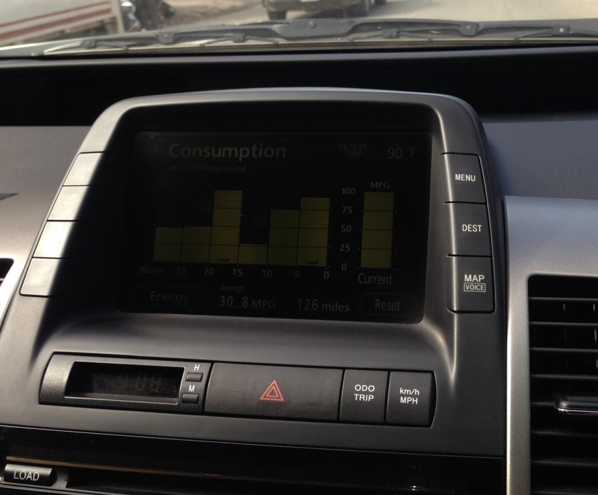

    I tried to capture the consumption screen again and it shown as in the attachment. I am not sure how i really Consumption.jpg did it and how this impacts the fuel consumption.
    Note: I am an aggressive driver.
    Thanks,
    sanlen

    sanlen, your screen shot shows very good performance from the car. In those 30 minutes, there are two bars @ ~50 mpg, one @ ~100 mpg, one @ 25 mpg, one @ 75 mpg, and one @ ~85 mpg. (Maybe there was a hill that you went over.) The average MPG that is showing on the MFD is much less than the MPG in those 30 minutes. So I think your driving and your car are fine. Push the reset button and see what the new value reads.
