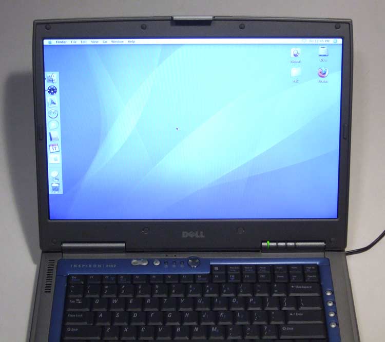

    What's even stranger is to see a Dell laptop running OSX (*not* Photoshopped!):
    Patrick Wong likes this.
