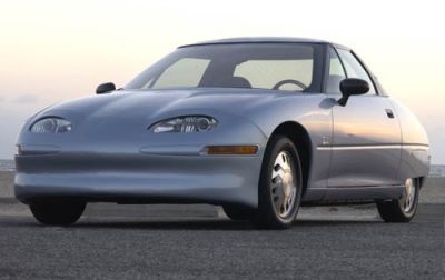

    I'm glad you got a chance to test drive. Ordinarily, I don't care about 'style' but in this case:
    • the hood looks like it has popped open
    • the front looks like a bunch of parachutes
    An ordinary engine powered car has to dump ~1/3 of the wasted heat out of the radiator. So a larger radiator inlet suggests a more powerful, ordinary engine. In this case, it suggests wasted heat, not efficiency.
    Ordinarily, GM styling turns me off but this is one exception:
    Minimizing aerodynamic drag elements on the front is the way my cars should (and have) gone:
    Air scoops are the signature of inefficiency: (1) an engine dumping heat, and (2) high drag.
