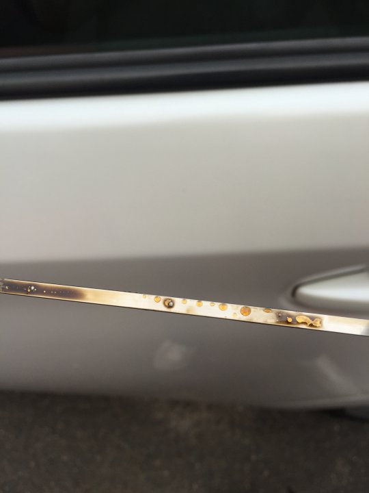

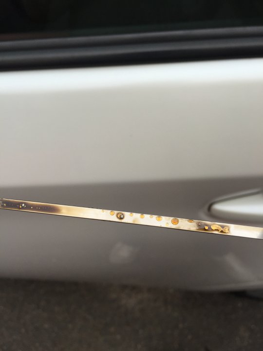

  9. 69shovlhed
    69shovlhed Surly tree hugger
    May 13, 2012
    2,170
    752
    Delaware
    if there is coolant on the dipstick, forget the injector. engine is toast.
  10. Steve Morris
    Steve Morris Junior Member
    Oct 29, 2017
    Melbourne
    2013 Prius c
    ----Australia----
    Water in the oil as well as the engine is misfiring, to me it sounds like a blown head gasket......
