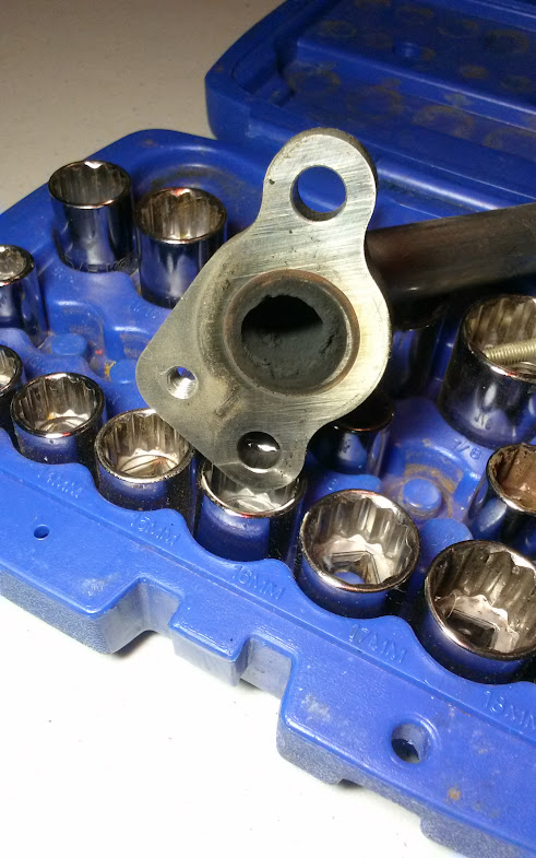

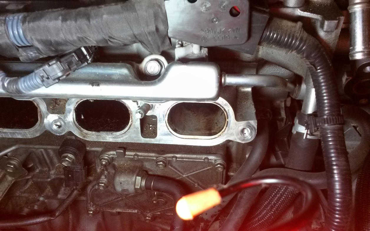

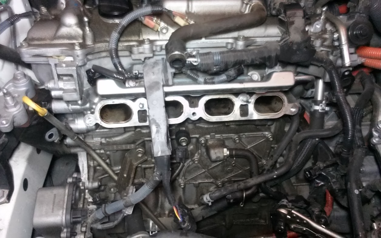

    So finally got around to this last night after I had to go into town to get something and it seemed I was always right at that point that the ICE would miss and knock. I had been putting this off until I had more time, but I couldn't stand it anymore after that. So I tore into it, took me just over two hours to complete. Really not too bad, just follow the parts until you get to what you need and then reverse it when you are done. I keep a portable table next to me while I'm working on cars and it really helps to lay out parts and their misc nuts and bolts in order as I go. Took some pics, sorry about the large size.
    Here is the condition of the egr tube. Mostly all dry soot material. I blew it out and then used some throttle body cleaner to get the remainder. No picture of it clean, use your imagination. No DIY tube block installed, though i may think about it if this starts happening more frequently. ;)

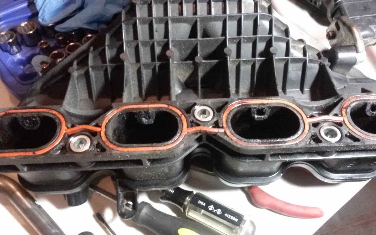

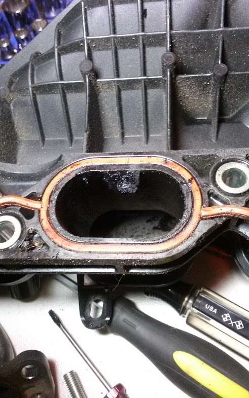

    Lastly here are the heads in the intake manifold. This was after some light blowing through the egr line, so the ones on the right may be partially clear...
    ...but the ones on the left, WOW! These things were almost entirely clogged up down the line, not just at the top of the hole. I used the small flat head in the picture to get in and pull out as much of the thick oily gunk as possible then used some pipe cleaners, then sprayed through with some throttle body cleaner, then pipe cleaners some more until it was mostly clear. Sadly I do not have a after shot of those since at this point i was just wanting to be done.
