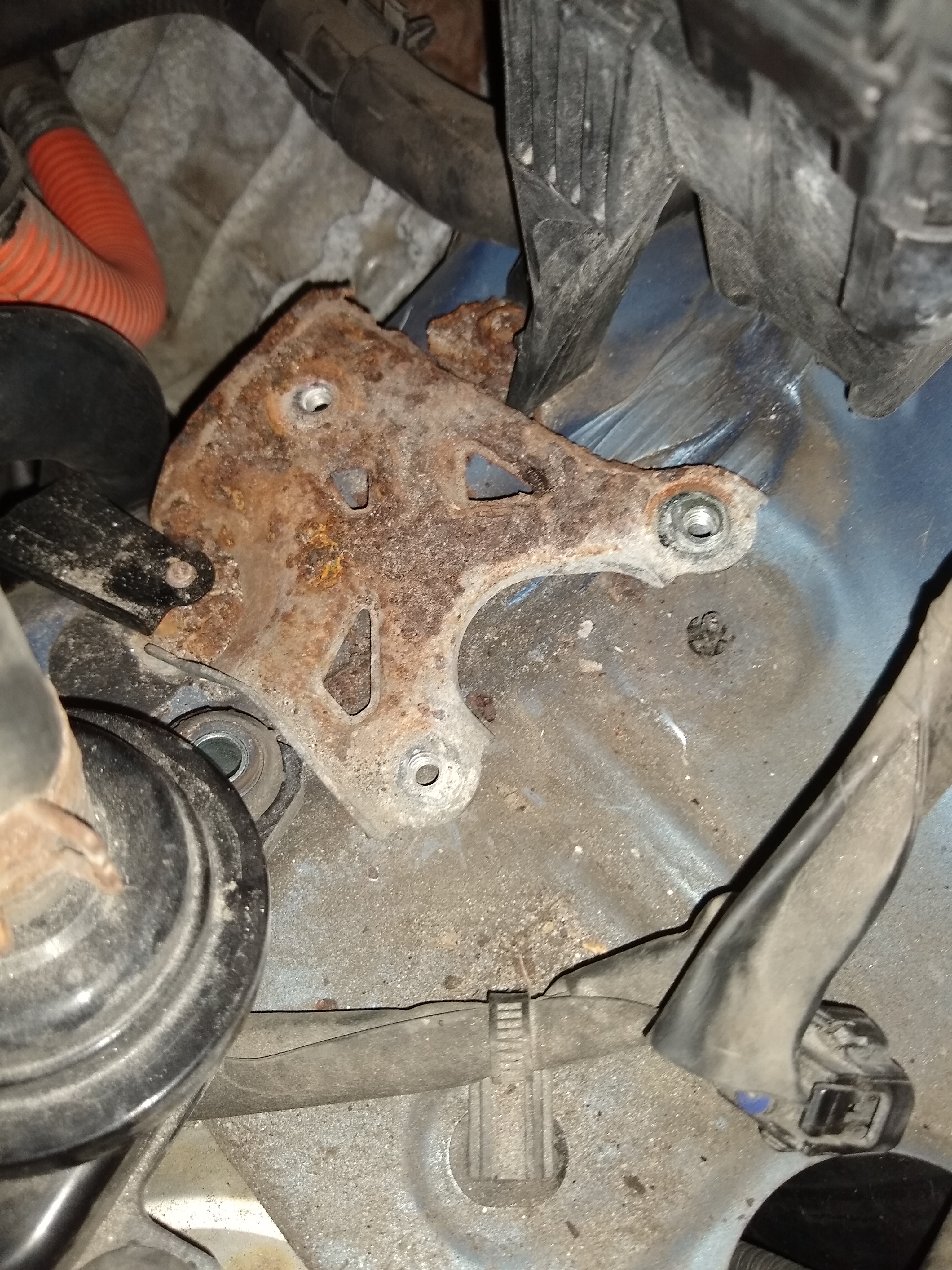

  13. TMR-JWAP
    TMR-JWAP Senior Member
    Aug 12, 2016
    6,404
    6,094
    Columbia, SC
    The rusted bracket is identical to the bracket that will be already installed on the new pump. Most people remove the new pump from the new bracket and just install the new pump on the old bracket. Yes, your old bracket is impressively rusty. Yes, the threaded holes appear to still be there, but the integrity of the bracket is in question. If you're up for it, then remove the old bracket, and then install the entire new assembly. If you're not up for it, then do it the same way as most do it....new pump on old bracket and it is what it is.
    lunarkingdom likes this.
  14. lunarkingdom
    lunarkingdom Junior Member
    Dec 29, 2022
    59
    southern California
    Sand the rusted area with sand paper to remove any high spots then use some rust converter on the sanded/rusted spits it will turn the rusted areas black and keep them from rusting in the future. Then install the new pump and proceed to bleed it and enjoy your new pump ;-)
    EDIT: use the new bracket suggested above if available.

  18. newtothisprius
    newtothisprius Junior Member
    May 23, 2022
    59
    Anyone have any guides to remove and install the bracket? YouTube seems to all have people who just replace the pump. Thanks.
  19. mr_guy_mann
    mr_guy_mann Senior Member
    Sep 3, 2020
    4,109
    2,011
    NJ-USA
    Well, the bracket is attached by two fasteners. There's a 6mm bolt that goes into the side of the frame rail. I think it also holds the bracket for the 3-way coolant valve. That bolt usually comes right out, no problem.
    The other fastener is a vertical 6mm stud and nut that is at one corner of the underhood fuse box. That nut is "always" seized and has snapped every time. Tried a number of techniques, still breaks. Now I leave it alone and reuse the old bracket- if possible.
    Or break it. Then move the new bracket a little over and use a self drilling sheet metal screw.
    newtothisprius likes this.
  20. newtothisprius
    May 23, 2022
    59
    That's the answer I needed. The bolt did look simple but I couldn't figure out what the other "screw" was. It looked like a torx screw.
