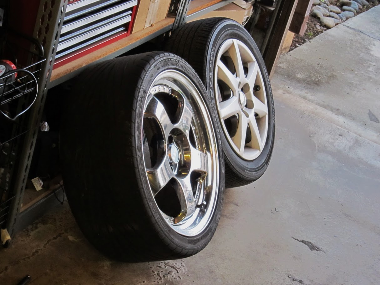

    I have a question about what mat you used to put those tires on haha.... it looks like it fits realitivley well for having the seats folded down. I travel with dogs constantly (always at least one German Shepard with me , but sometimes with both of them) i took out the back seat "backs" and covered the fabric interior with a blanket ....anyhow i would prefer to have the rubber matt all throughout the back to cover the seats as well. BTW nice work with all the mods, im still trying to determine what i am going to do with the tail lights because they seem so difficult.

    I assume you are talking about the photo of my E61. The rubber you see if the oem cargo cover which only covers the floor behind the seats when they are upright. When hauling items like this, or sometimes our dog with the seats down I lay an additional moving blanket or rear seat cover on the seat backs.
    For you as a dog owner, I would recommend one of the rear seat covers as seen below, it does a great job at protecting the interior regardless of seat orientation. I bought mine from TJ Maxx or Home Goods for $15 or so.

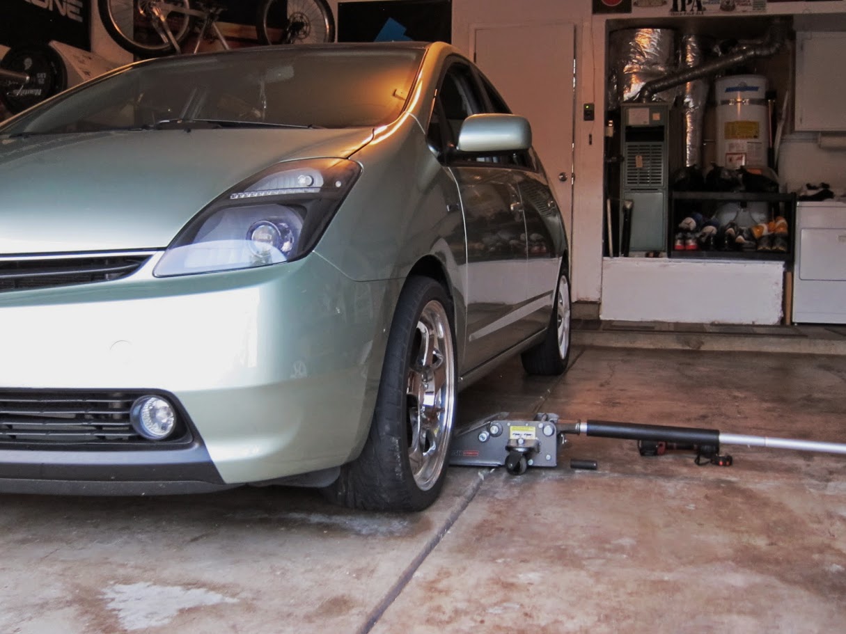

    Just read this thread from the start and daaaymn. I've been trying to hold off mods on my prius and keep it stock and functional for the bit over a year I've owned it, but after seeing this, I need to tinker more.
    Those headlights!!! Any info on the projector you used? I have the normal halogen headlights at the moment, do you think I'd have to do anything special besides wiring in the ballast and normal HID stuff?
