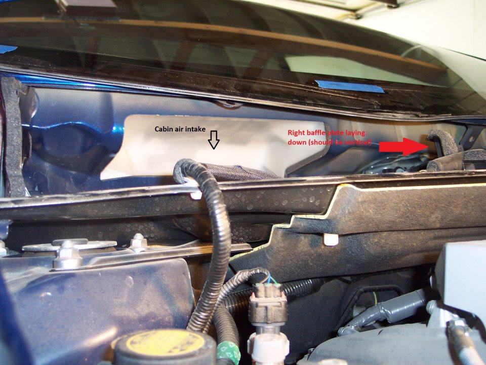

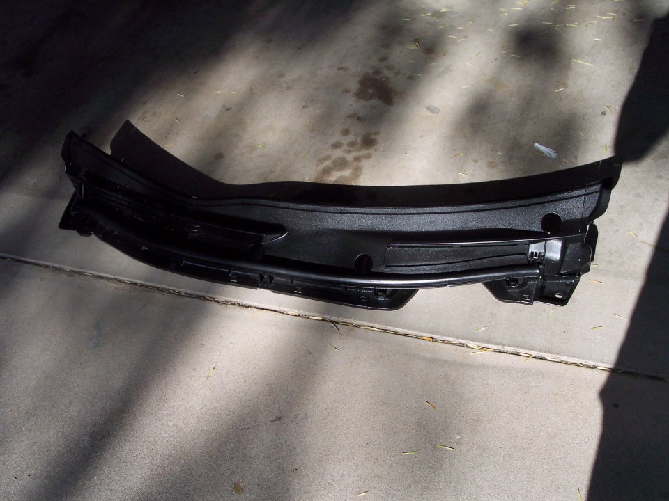

    There is one more possibility...I had forgotten this but there are some threads here that discuss rodents that make nests in the outside air intake box. You (or the dealer) would have to remove the plastic trim piece beneath the windshield wiper blades to see inside that area. This could also be the cause of the strange odor. There are some mods on how to make it rodent proof. It's worth checking into if you are convinced the odor emanates from the AC system. That and a professsional evap coil cleaning should get rid of any odors from the system.
