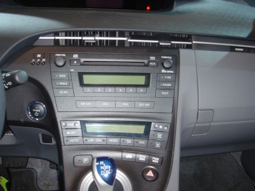

    I rarely use AUTO mode because it likes to go to recirc. I only want outside air but either setting is not the culprit. Your preventive measure is hopefully going to keep it in check. I (fortunately?) have never had this problem and I had the Lexus LS460 for a few years (amazing car but made me feel pretentious...my problem). It is such a noxious smell especially first thing in the morning to get blasted by mold/mildew, it takes your breath away...literally. I should have probably tried Lysol first but I wanted the highest rated and specifically made product I could find. There is a mesh on the outside fresh-air grill that prevents passing a tube down into the coil chamber. I could have made a slit in the mesh but the instructions on the product I used said to go through the center dash vent. It worked instantly and not just as a coverup.

    I've noticed that mold smell the last few days too... we just got over a 10 day heat wave with temps in the mid 90's to 100 so the AC was on constantly.
    You say you sprayed with the tube in the "center dash air vent"? Is that the two vents directly over the CD player slot?
