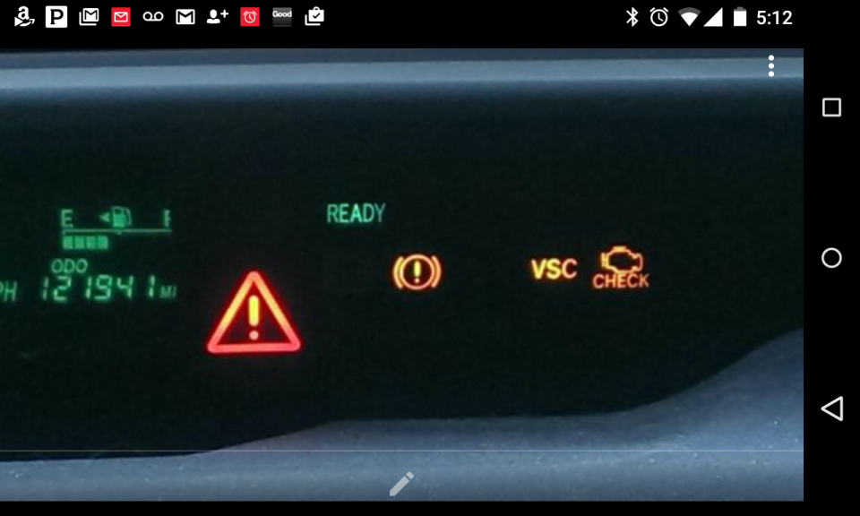

    As I am posting this my mother is returning from a road trip in her 2007 Prius. She said the red triangle, the "amber circle with an exclamation point and in parentheses", "ESC with check engine light beside it" (perhaps I misheard and this is "VSC"?) and "maintenance required" are all lit up. She said once it told her there were transmission problems.
    The car will drop into neutral if she goes over about 45-50 mph.
    She checked the owner's manual and called a dealership, and I did some quick internet searching, and there doesn't seem to be an immediate danger to continue driving at reduced speed to get home. Please correct me if we're wrong.
    After a quick scan here, I found the following in one of the stickies. This sounds like a candidate cause. I wouldn't call this a hot day, but this is Texas and it ain't cool, either.
    I have an OBDII Bluetooth Dongle, so when I get to her car--when she gets home or when I pick her up, depending on how things go--I'll get the codes.
    If anyone has an alternate long-distance diagnosis I'd appreciate hearing it. If it is this inverter pump, is it something easy to do oneself, or is it time to go to the mechanic?

    • The fault code from the OBDII is P0a93 which is for the inverter cooling; I don't know why it kept going for her instead of stopping like for others. There was also a "pending" fault code P2238, and I haven't found exactly what that is yet, but the warning lights sound very similar to the one for P0a93 and what we're seeing.
    • I opened the inverter coolant reservoir with the car on and couldn't see any turbulence in the coolant as seen in that 36-second first video I linked earlier.
    • I was dumb in that I didn't take a photo of the warning lights for reference, but I will try to get that today.

    Mom called again with warning lights again. She recently (< 1 month) had the 12v battery replaced, and everything was fine. Actually everything is fine except the dash lights. She'll take it to the dealer in the morning, but I thought I would post this here and see if anyone says "oh yeah, that means this". In my quick Google search I don't see what this means.

    This is an old thread, but fits my symptoms nearly exactly - we've solved it, so I thought I'd post for future users.
    While driving I had noticed the engine seemed to really run fast- it was trying to charge the traction battery (which was low because of a lot of sitting still with the AC running, but it was unusual that the car really seemed to struggle to accelerate from stoplights - noticeably strained compared to same condition without the pending failure (which hadn't fully occurred yet). A while later, the AC air speed suddenly dropped noticeably - strange, so I checked, but it was still set to "high" where we had left it. A couple miles later, we heard a long tone along with the "red triangle of death" followed by a couple other dash lights, then another tone a moment later with many more warning lights showing - check engine, VSC, ABS, tire pressure warning. Ironically, we had just filled up the gas tank also, 14 miles before this, but I want to point out, that is just a coincidence and is not part of the cause.
    We were able to keep driving the last 1.5 mile home, no problem, and I immediately checked with my Torque app. P0A93 and P2238.
    And I checked my custom view of battery and temperature readings and noted the traction battery was hotter than normal and the inverter was very hot, > 180 F.
    After it all cooled down, I checked again and most dash lights were dark and it only showed the P0A93 code. This matched what I figured - the other lights and code were a cascade-of-failure effect... bogus. The real problem was the P0A93.
    With the car on and "ready," I checked the inverter coolant reservoir... looked like a tranquil lake; no movement at all - silent.
    Definitely a failed inverter coolant pump, or electrical problem for the pump. We figured the pump was bad.
    We bought a new inverter coolant pump and replaced it; took about an hour because we were "learning," but could be done in 20 to 30 min using the technique we devised along the way - I note it below. After replacement, we cleared the code and checked the coolant reservoir - it was obviously turbulent. Sorry for bad pictures... they were captured from a video.
    And when running on a warm day with the AC blasting, both stand-still and freeway speeds, the inverter heated up and cooled right back down as we expect it to, getting to a maximum of 136 F for just a moment and normally staying in the 110s.
