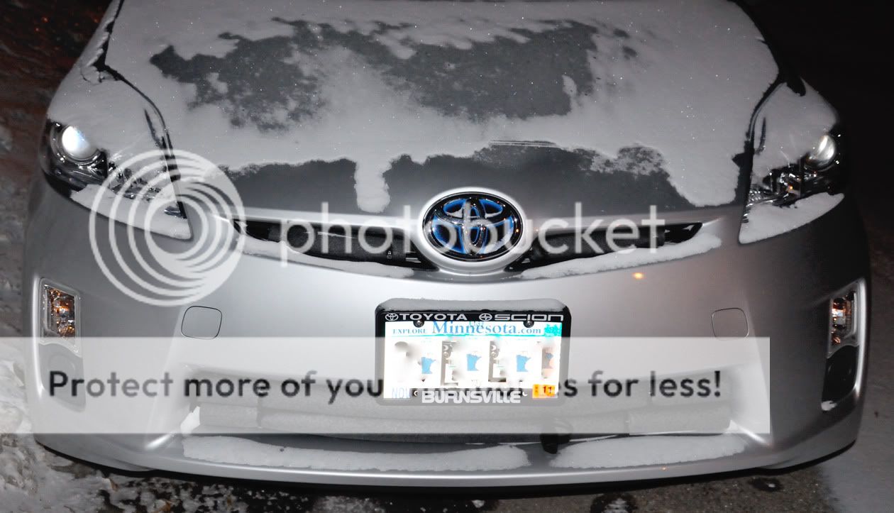

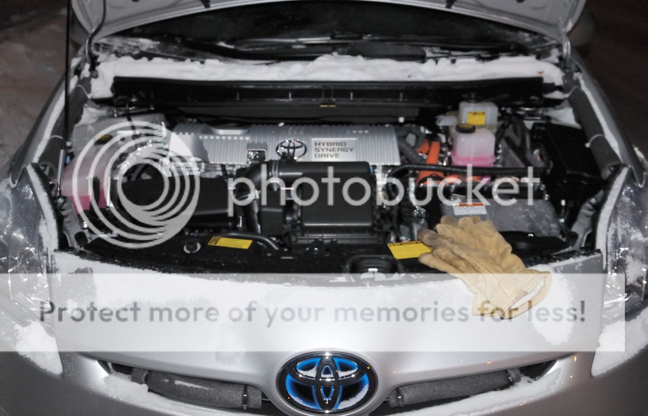

    I was a little worried whether the hood would come in contact with the insulating material (generic 3/4" pipe insulator material, $2.99/bag from Running's), but the line of ice running along the top surface would seem to indicate that there is. It is inelegant, but appears effective. No laughing.
    First up, ghetto grill-blocking. I used zip-ties to keep mine in place because it was windy & cold & my fingers were getting numb:
    Next, a fuzzy bilateral view of the interior aspects:

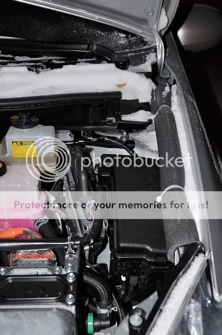

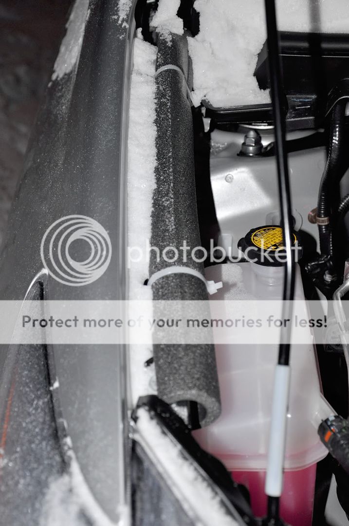

    Driver's side:
    Passenger's side. Zip-ties are not color-coordinated:

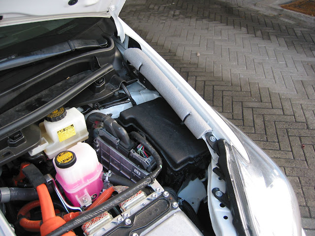

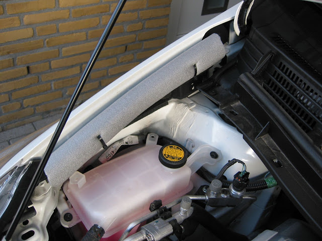

    Thnx to the OP, I discovered your mod last week and applied it to my car. I already had 100% lower and 60% upper grill block on my gen3. I can't yet say that it does approve mileage, temperature readings with my OBDKey show that the car is doing fine. No problems whatsoever. First impression is that the time the ICE is still warm when the car is parked, is longer now. Outside temperatures are around +2 celsius.

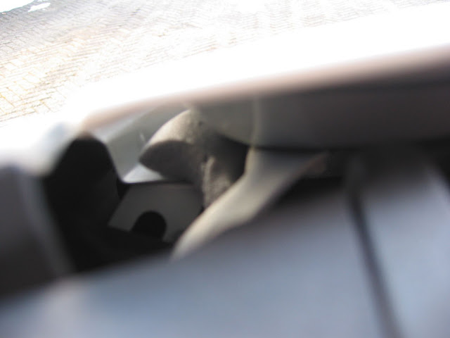

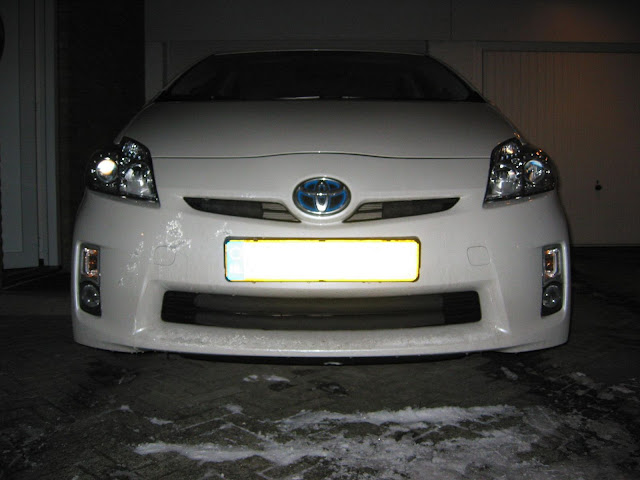

    Here are some pics of this mod
    [​IMG]\
    above left and right side with piping insulation. Beneath a picture from the top of the hood looking down
    This one shows the armaflex black piping insulation I use for the grillblock.

    i'm very happy that my mod is usefull for you.
    The idea is to keep warm the ICE while in park, and noise insulating too the ICE.
    Great photos, congratulations.
    I look for other motor compartiments, like Mercedes, and see that the hood is totally insulated while closed. And then i think my prius too.
    If you have any question, i'm pleased to answer you.
    Salu2.

    Running the zip-ties through the material rather than around as I did makes more sense. Thanks to you, I get to modify my own mod. I appreciate your pics. Nice job.
