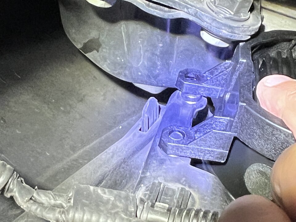

    So after searching this forum and other research I pulled the trigger on some Morimoto XB LED fog lights. They had a great sale on them at 40% off that made it worthwhile. So I though….

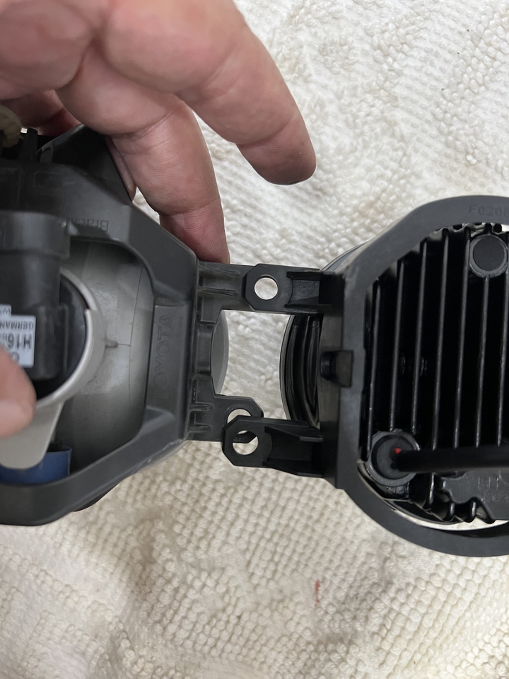

    Once I got them and went to install, they didn’t quite fit. I started on the drivers side and the two outside tabs did not line up correctly. And this is the side that has the single screw to hold them in. I then put it up to the factory fog light and it shows where the tabs are off.
    Uggg….
    I’m a little bummed but I’ve started the RMA process…

    Odd. On the Japanese built 2012 v, mine were plug and play.
    Perhaps the mounting point specs changed on the 2016?
    I recall Morimoto did say for 2010-2016 Prius, generally, but things can and do change.
