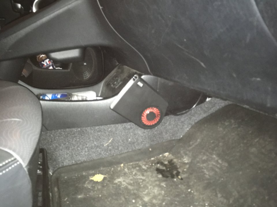

    Norwegian here. Got a DEFA block heater and cabin heater in my Prius Plug-In as well as in my Lexus (and had it in my Corolla too).
    The block heater (sits in a freeze-plug spot) warms the block pretty good. You can "feel the heat" with your hands on your block even on cold cold days.
    The cabin heater is the best part though (and the most important part since I'm plug-in and don't wanna run the engine). It heats the interior to comfy temperatures (+20'C/68'F) within a few hours and melts all ice on all windows. Another plus is that it seems the battery pack "likes it", giving me more EV charge when being charged at "room temperature" rather than several degrees below freezing.
    Here's my 1900W heater installed.
    There's a T-joint near the block heater where the two heaters are joined, and a female plug mounted in the front bumper where I connect the power lead to the outlet (has a timer) on my house wall.

    Where can I buy the heater in your photo?

    DEFA is a Norwegian company, but I see they have a North America-office in Toronto, lol
    This is the heater in question: DEFA / Interior heaters
    You can find it on eBay (1400W will also do very very nicely) too, but I'm not sure if it will work with 110-130V power (Europe uses 220-240V in all household sockets).
    I'm sure there are plenty of alternatives to DEFA though. Especially in Canada, where they might use 110V and/or ship to the US.
