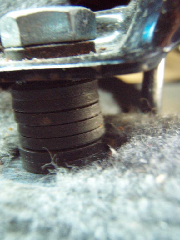

    I'm going to try that washer thing...I think it's exactly what I need. Maybe it's my size/body type but I feel like if I put my seat back far enough to have the leg room I need that I'm leaning forward to grab the wheel. Maybe this will correct some of that.

    What some have done..
    What I ended up doing..solid single spacer

    As I posted in JustDidIts other thread, you should know that "that washer thing" could present a serious consequence in terms of safety. The seat is the only thing keeping you from flying out of the car in a rear-end collision, and if you reduce the strength of the seat-to-body connection, well... it's your safety... but I wouldn't do this to my car.
    At the very minimum, you should be using grade 8 hardware for this. Even better would be to use large fender washers in place of the smaller machine washers. Best would be to have a proper bracket fabbed up, but I doubt this has been done yet.

    as someone pointed out
    stacked washers like that is hugely dangerous, and could easily pop in a collision
    if you are going to do this, use thick wall pipe (as opposed to tube) as you can with grade 8 fasteners and adequate bearing washers. at the end of the day its both the seat equipment and the lack of adjustment that makes them uncomfortable.
