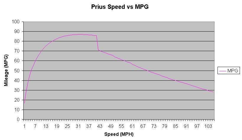

  7. kk6yb
    kk6yb Junior Member
    Oct 24, 2005
    36
    San Diego, CA
    2011 Prius Alpha
    I made a graph of Speed vs MPG using Wayne's Prius simulator and the best steady speed is in the 30's. The graph peaks at 32 mph. Avoid > 41 mph, mileage drops suddenly at 42 mpg due to spinning the ICE, and steadily above that due to drag.
    This simulation is for 68F, sea level, 40% RH, 29.92", 225 payload, no AC, no wind. Click on the graph to download the excel spreadsheet.
  8. bwilson4web
    29,111
    16,549
    <div class='quotetop'>QUOTE(kk6yb @ Feb 15 2006, 04:22 PM) [snapback]210092[/snapback]</div>
    I disagree with this graph:
    1) It does not reflect the lower power requirements at speeds below 41 mph.
    As the vehicle rolls slower and slower, the aerodynamic componet goes to zero. This means the energy required to keep the vehicle rolling has gone down. Yet this graph shows not only a flattening but worse, an increase in power required. I do not know if the simulation is wrong but the graph is wrong.
    A more accurate graph, for the NHW11 03 Prius is:
    The simple act of benchmarking the various speeds has confirmed the above chart is accurate:
    http://hiwaay.net/~bzwilson/prius/pri_test.html
  9. ken1784
    ken1784 SuperMID designer
    Dec 18, 2003
    2,943
    1,384
    67
    Yokohama, JAPAN
    <div class='quotetop'>QUOTE(bwilson4web @ Mar 11 2007, 01:07 PM) [snapback]403612[/snapback]</div>
    Hi Bob,
    I don't think we can perform 120 mpg at 5 mph.
    We need 24 hours to drive 120 miles by 5 mph.
    Prius requires about 300W to maintain itself, "basal metabolism". About 7.2 kWh for that 24 hours is a lot of energy compare to just against driving resistance.
    I would like to support Wayne's simulator.
    Ken@Japan

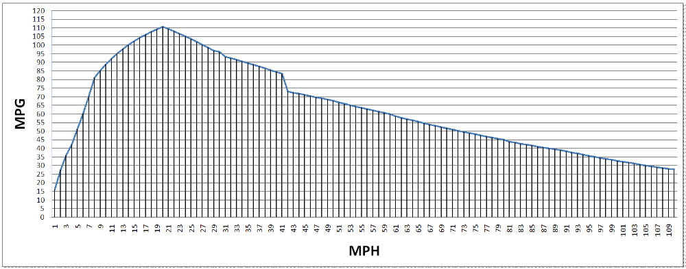

  13. mwbueno
    mwbueno New Member
    Oct 25, 2005
    37
    Hi all,
    Find below a graph depicting what the latest Prius Energy Use Simulator outputs. Over the last 3 years I have gone out and performed several low speed tests to get better low speed data which was quite lacking before. A surprising things to note is that 20 MPH is the absolute best speed for high mileage in a Prius. This actually surprised me so, I tested for it several times. All tests were done without implementing pulse & glide techniques. I simply kept the speed on a level test track on non-windy days & let the HSD cycle through several full SOC patterns before taking the average. The graph below is based upon the following input variables:
    Temp: 88 F -- About as hot as one can do without A/C & windows up for several hours.
    Elevation: 400 feet above sea level
    Humidity: 59%
    Barometer: 30.03 in/hg
    Wind: NONE
    Auto A/C: OFF
    Fuel: Summer Blend 114,500 BTU per Gallon US
    Road Rolling Resistance: Smooth Dry Asphalt
    Tire Rolling Resistance: 0.0077 -- OEM Integrity @ OEM pressures
    Best Regards,
    Wayne -- http://privatenrg.com
    2 people like this.
  14. usbseawolf2000
    usbseawolf2000 HSD PhD
    Sep 22, 2004
    14,487
    3,002
    Fort Lee, NJ
    Thanks for your hard work Wayne with all these testing. Oh wow! 110 MPG at 20 MPH.
