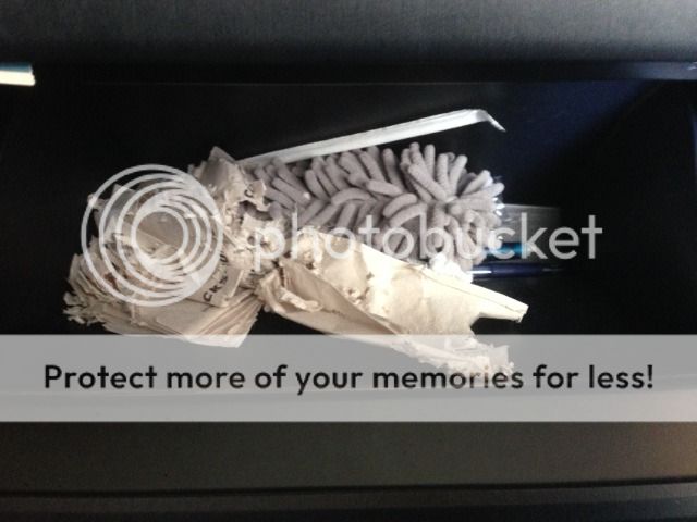

    I decided to thoroughly clean the car, vacuuming everything, including removing the rear seat, washing the floor mats, and wiping down all surfaces. While cleaning, I discovered tattered napkins in the glove box; the tell-tell sign that it had been a rodent playground.

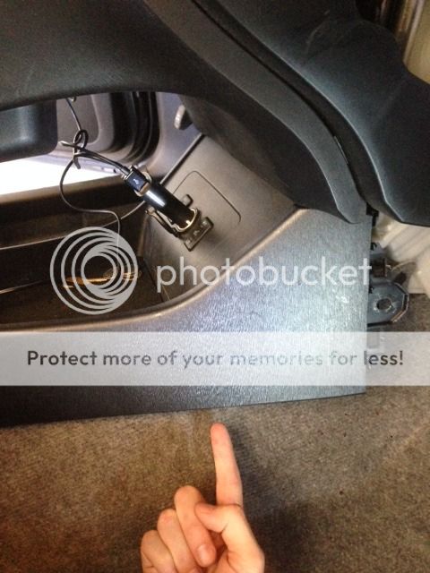

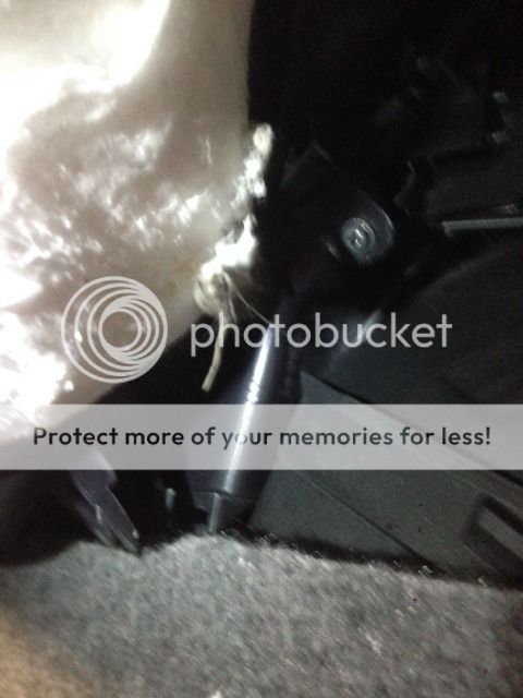

    After cleaning, the smell was just as strong as ever, and I realized I would have to purposely bury my nose into every cushion and crevice until I found the source. After about 10 minutes of sniffing around, I concluded that the strongest stench was emanating from the center console. I ran my hand under the plastic cowl where it met the carpet, and to my horror, felt something squishy.

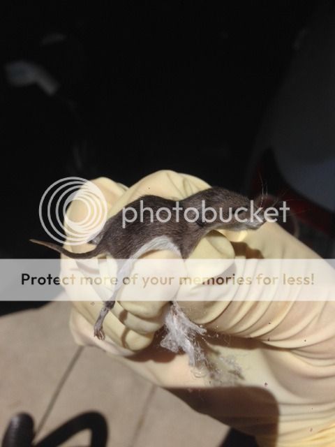

    The shrew had died while clinging on to the white batting of the cover, and I had to pry it out along with a chunk of the white insulation. Although I hadn't eaten in over 15 hours by that time, I wasn't hungry.
