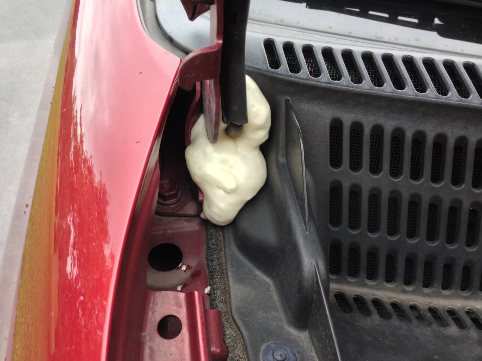

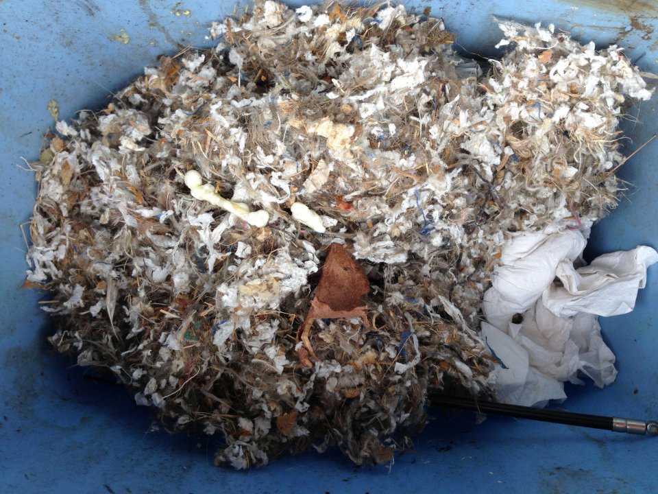

    Johno Junior Member
    Apr 23, 2004
    71
    Chester Springs, PA
    I was stunned to find this huge mouse nest in my cabin filter in my 2004 Prius. I sprayed foam insulation under the hood in the openings where the hinges are located. So far so good. IMG_0598.JPG IMG_0600.jpg
