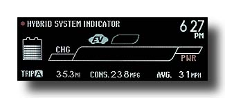

    Wow, what an unfriendly response. I just got my 2013 Prius Three 2 days and I'll be darned if I can find the average MPG. And yes, I've read the manual until it's dog-eared already. If I'm reading it right, it should show up next to the Trip A (and Trip B) miles, but that figure says 20.1. (I have only 40+ miles on the car). I find it hard to believe I'm only getting 20 MPG. But far be it from me to ask someone thousands of miles away for their input on a Prius Chat board.

    I don't know if the 2013 is the same as the 2010, but in addition to the Trip button, the DISP button switches the readings. When you're on Trip A or Trip B, hit the DISP button to see if the different displays give you what you're looking for.

    I guess I found the answer. I reset the Trip to zero and now it's showing about 50 mpg. I guess the 20 was from moving it around the lot before I bought it. Thanks to whoever suggested that - the manual certainly didn't mention it, my friend Teakwood.

    I've had my car all of 2 days, and have been getting increasingly frustrated about finding real-time consumption. Similar to the original poster, the bar chart doesn't do anything for me. I've been cycling through the displays and getting annoyed. I just want a number - not a lot of graphics! So your guide is very helpful - and it seems I need to be viewing trip statistics. It's completely non-obvious to me that the numbers don't show unless you've set up(?) or are viewing a trip. I will try this on the way home. (But I don't see why you should have to have a trip set up for the real-time mpg. It should just be there, staring you in the face IMO....)

    That CONS. value is the consumption average for trips. It's numeric.
    It's what I use most, especially having upgraded from a regular model to a plug-in.

    If there was one that just "stared you in the face", then it would only indicate lifetime mpg. I reset Trip B at every fill up for a tank average and Trip A after getting to work and after getting home from work for a trip average. I also do manual calculations after every fill up as well and compare to Trip B. Trip B is alway "optimistic" by 2% to 6%.
