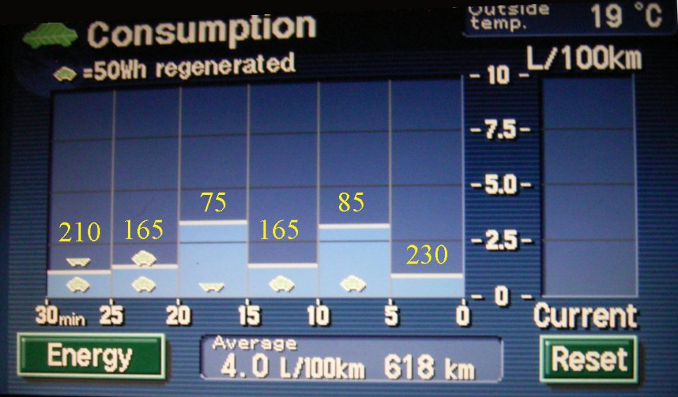

    Ok, that low figure makes a bit more sense then.
    If you get a chance for another test drive try looking at the 5 minutes averages (it's a bar graph that you get if you hit the little on screen "consumption" at the bottom of the energy monitor screen.)
    After 20 minutes or so the last 5 minute average should be showing marked improvement, like somewhere around 50 MPG if your speed is under 65 MPH.
  9. uart
    uart Senior Member
    Sep 7, 2009
    4,220
    1,212
    Australia
    Hit the "consumption" button at the bottom of the energy monitor screen.
    BTW. You can ignore the numbers on this one, this was just me showing off. Yours will show MPG instead of L/100 km.
