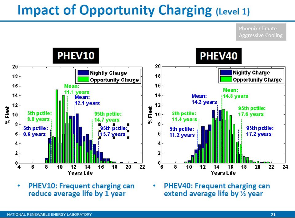

  12. John H
    John H Senior Member
    Jun 4, 2012
    2,208
    558
    But opportunity charging can shorten the life of the battery pack without aggressive cooling.

  16. usbseawolf2000
    usbseawolf2000 HSD PhD
    Sep 22, 2004
    14,487
    3,002
    Fort Lee, NJ
    John, we have been through this before. PiP has active cooling with 2 fans with conditioned air drawn from the cabin. It is not "aggressive cooling" (neither Volt) but good enough to last 10 years / 150k miles warranty with opportunity recharges.

  19. John H
    Jun 4, 2012
    2,208
    558
    You observed that the PiP does not automatically cool the battery while being charged, even with the fans.
    The Volt does aggressivly cool the battery during charging.
