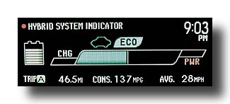

    Unless it looks like this, you're not actually in HV mode:

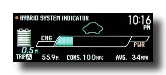

    This is EV-BOOST mode, which depletes even though the engine is running:

    john, can you give us more details please? what are we looking at on the screens and what differences are we seeing? thanks!

    The top screen with the line in the middle and the ECO icon and the battery with the stripes is the standard Hybrid display, like you would see on a non-plugin. The empty car outline signifies that the ICE is on. If the ICE is off, the empty outline is filled with "EV".
    On the bottom, you are in an EV mode, but the the ICE is running for some reason (like needing heat, or going over 62mph), as indicated by the empty car outline. You are getting power primarily from the battery, and the battery is being depleted. Normally in EV mode, the battery icon is solid up the the level of charge, but when you have less than a mile of EV left, it shifts to the HV style. Also note that in the bottom display, the car icon is where the "ECO" icon was in the hybrid display, and it is bigger than in the HV display.
    Just at a glance, the bar in the middle is the simplest way to know you are in HV mode.

    There are 2 different modes available while driving faster than 62 mph (100 km/h).
    Regular HV is when you explicitly push the button to halt EV depletion. This causes the Prius to revert to the usual 50 MPG hybrid driving.
    If you don't push the button, the default EV mode transforms to EV-BOOST mode. This causes the system to take advantage of the plug-supplied electricity, which results in efficiency above 100 MPG.
    When the EV symbol is small and the Eco-Meter has a center-divider to indicator a white zone, that's HV mode. It will remain that way until push the button again or shut the power off.
    When the EV symbol is large and the Eco-Meter only has a green zone, that's EV-BOOST mode while driving fast. It automatically turns into EV mode when you leave the highway and changes back to EV-BOOST when you exceed 62 mph... or you accleration hard... or the heater cycles back on.
