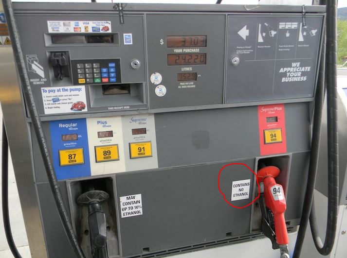

  2. Mendel Leisk
    61,540
    42,349
    Not sure if it's just in Canada, but Chevron (and some others?) offer ethanol-free gas, in highest octane only.
