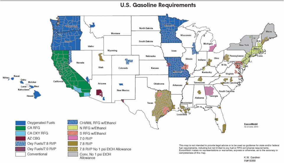

    Sounds like a long commute...do you think you get as far out as where they sell non-refomulated gaso? I can upload a map.

    Here is map of gasoline requirements (reformulated gasoline etc).
    If you go to the LINK there is a very detailed PDF you can zoom into your area to see the county lines.
    The is also an EPA web page that lists counties.
    Well 17 miles probably does not get you out of the East Coast RFG zone
    U.S. Gasoline Requirements
