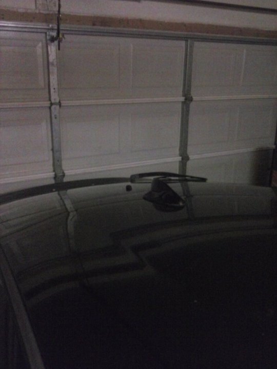

    First mod: shark fin from PriusChat shop: CAM00107.jpg
    I get comments about this all the time from fellow Prius drivers (esp 3rd gen). Apparently the 3rd gen "limp" look is unflattering.

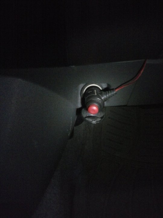

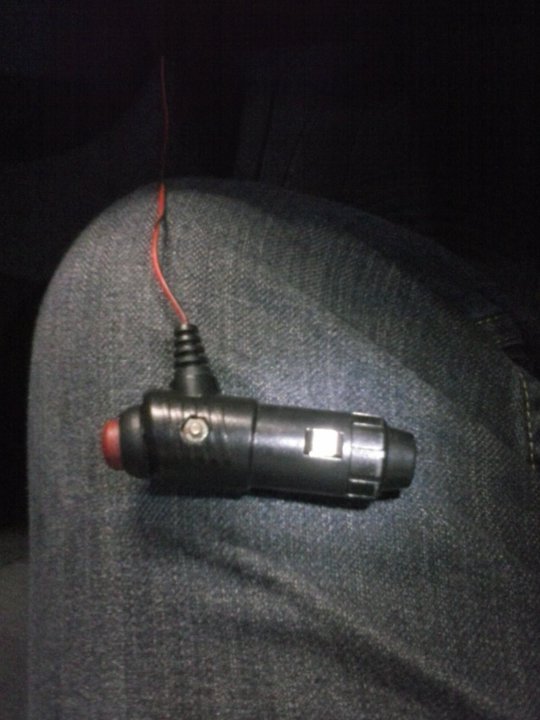

    My own version of EV button mod: CAM00098.jpg
    I installed a button into an old lighter plug (just need the ground to activate EV mode) and plug it into the lighter socket. Handy for moving the car around the driveway without starting the engine, and being a ninja.

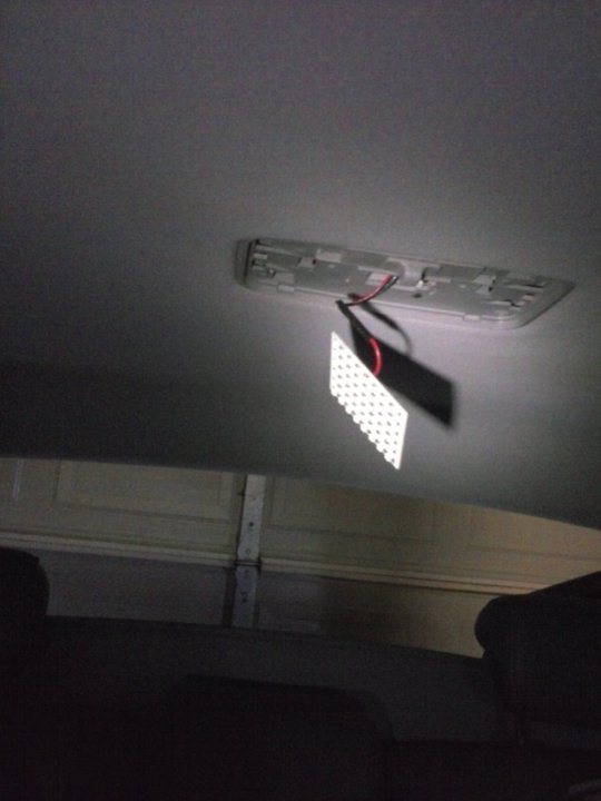

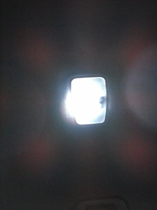

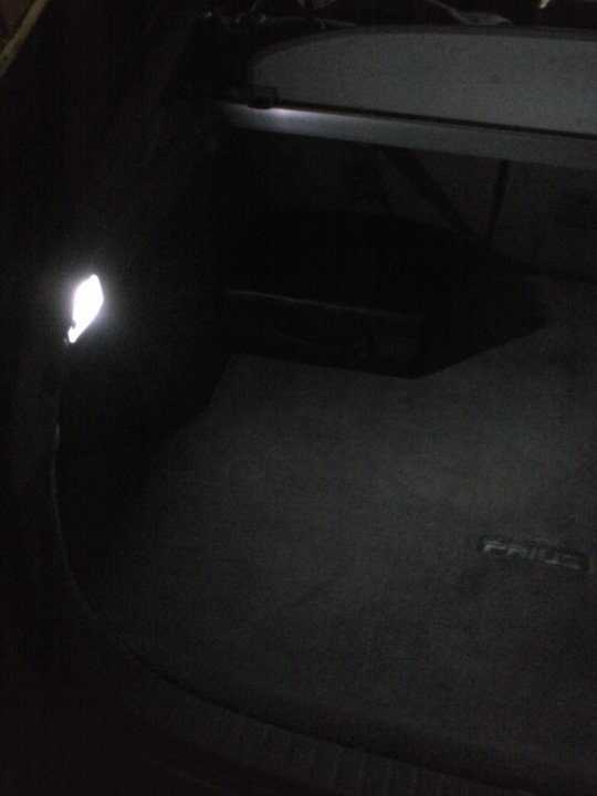

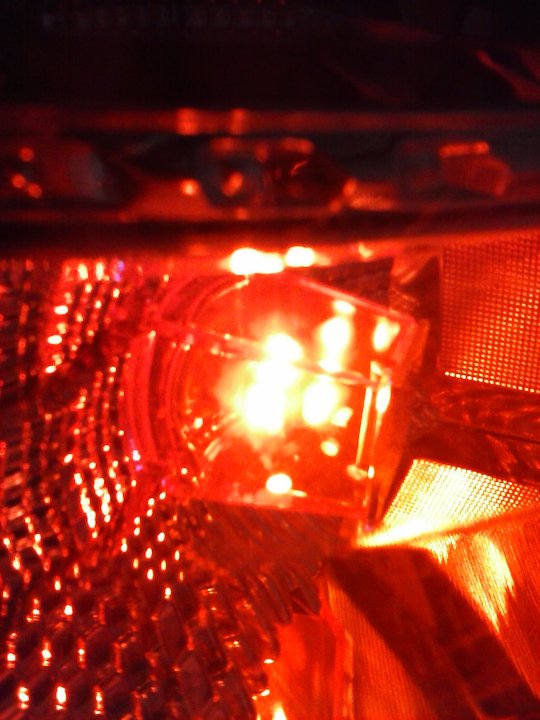

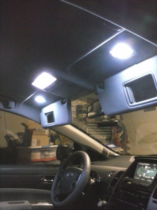

    Interior LED upgrade:
    So much better than stock. Also did the rear tails and license with LEDs.

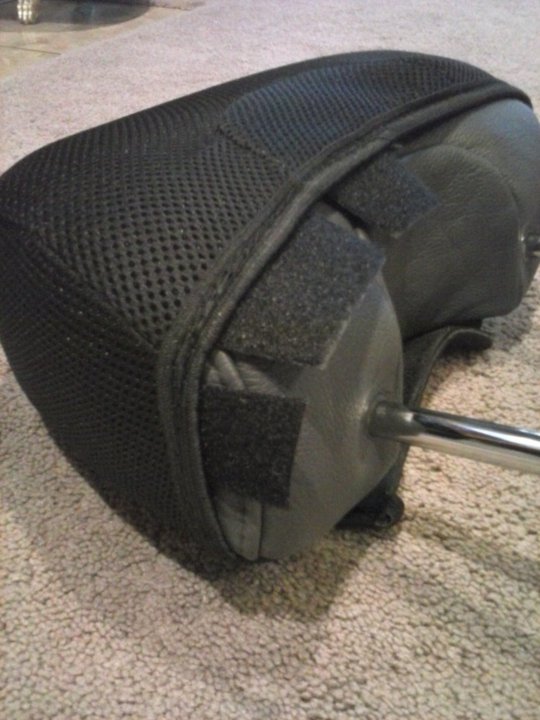

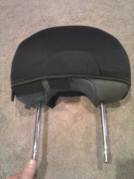

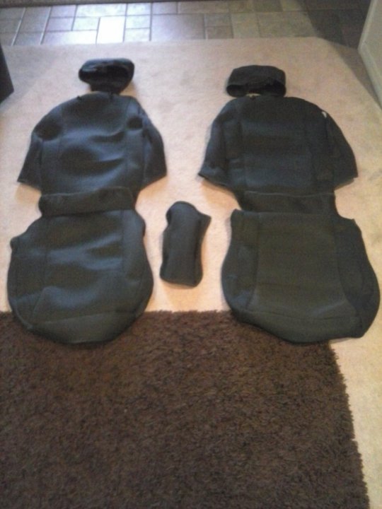

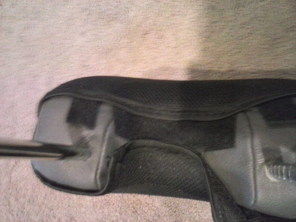

    New seat covers:
    I've got port installed leather, but I like to keep it covered to protect it.
    I like the quality of the Coverking covers, but I have contacted them about the misaligned headrest velcro and fitment. I can't get the velcro to stay shut.

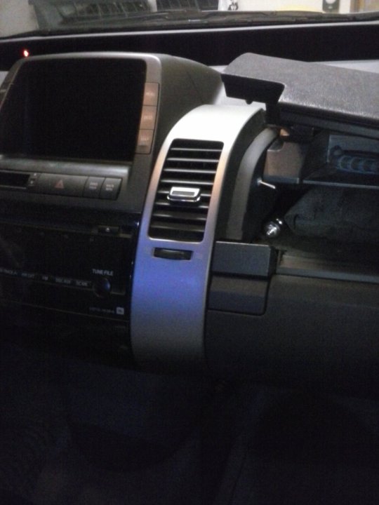

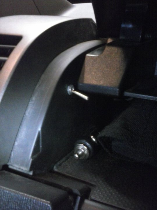

    Just tonight, I figured it was time to defeat the Nav and phone lock out when traveling more than 3 mph.
    I really like Bronson's automatic circuit, but I wanted something NOW, so I put the 1/4" DPDT switch in the upper glove box.
