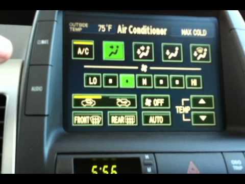

    I have a 2005 Prius and I noticed something odd, from 2004 to 2005 I noticed that the graphical design for the User interface was changed in the later years of the generation 2 Prius.
    For Example
    2005
    2009
    I do know that the changes between the model year systems where aa higher resolution MFD Display and And the switch from an analog-based system to Digital, and that there was a recall that did involve an update to the prior year's Systems due to what I can recall an engine issue. Does anyone know if it is possible to have the sysem updated to match the UI of the late 2nd gen models?

    I don't think it is a change with model years, as my owner's manual refers to both; it calls the first one above Type 1 and the second Type 2. I had a 2006 with Type 2 and my current 2006 has Type 1. I think it is selected by the region dealers when they are picking the model packages.
    As to whether you can retrofit, I have no idea.

    The "Type 1" (older design) was standard on 2004 and 2005 vehicles.
    On 2006-2009, they were standard on vehicles without a backup camera.
    Those with a backup camera got the higher resolution "Type 2" screen (bottom photo) with the updated graphics. That's the difference between the two.
    As for upgrading, I'm not sure. Could be software only or you could require both software and hardware upgrade. I don't know the wiring scheme behind the MFD.
    Both 2004-2005 and 2006-2009 can have both types of frames (4 button or 7 button). The 7 button means the car has navigation
    KellyC and Abdulaziz_Barham like this.
