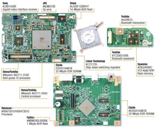

    afaik the only way to have the bluetooth lose its phone book is to press the delete buttons on the mfd, or a bad bluetooth board,and looking at pictures it sure looks to me like the toshiba/denso bluetooth board is seperate from the mfd.
    also because the phone book is not lost when you disconnect the 12v battery, it is assumed that the phone book is stored on its 512k flash ram, and it would not simply be erased...
    i hope they fixed it

    The impression I got (this was not explicitly stated but what I understood them to say) is that the bluetooth board is located inside the MFD and they don't troubleshoot at that level. ie: If anything contained in the MFD fails they simply replace the MFD and let the factory refurbish it. If that is the case, the factory will simply replace the bluetooth board and release the MFD as a refurbished unit.
