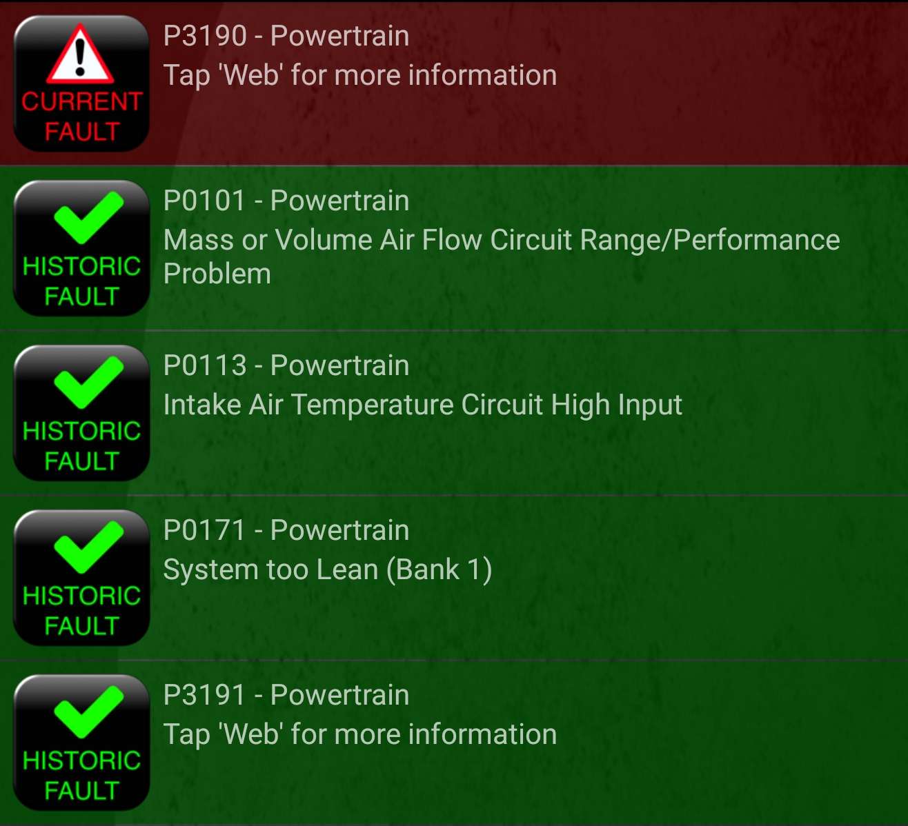

    Here's whats thrown
    P3191
    P0171
    P0101
    (P0113 & P0102 - appeared after cleaning MAF sensor.)
    Noticed that the engine was reving high and not auto shutting off at lights or when parked, even well after the engine was warm. Initially the CEL codes were just P0171 and P0441. I checked the gas cap and found it was slightly loose, so I clicked it and cleared the codes. On the way home the engine seemed to function as normal, it auto turned off at when stopped at a light but about half way home the CEL came back on. I left it "on" while I found my OBDII scanner, after hooking it up it was just the P0171 code but then the engine started up and was surging and then when it tried to cycle off it knocked and sputtered pretty bad and then died. The check hybrid light came on.

    Current codes:
    Thank you.

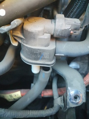

    Went on to the next step from my OP and investigated the Purge VSV and low and behold the hose to/from? the intake has blown off.
    Based on other posts this vacuum valve seems to be a known issue but Toyota says the T-SB-0041-15 doesn't apply to my vin
    I put the hose back on and reset the codes.
    ICE runs without throwing codes immediately as it was before replacing the hose but there is the intermittent surging that was occuring before and the ICE isn't consistently shutting off at lights.
    The part that the hose came off of is 90910-12279 but it doesn't come up on Toyota's website.
    Looks like it should be 25860-37020? Can anyone confirm?

    P3190---Poor Engine Power
    May want to start with a quick fuel pressure check 44-50 psi

    Replaced the Purge Valve. Took it for an hour drive, mixed highway and city, and surging is gone, ICE auto stops at lights and when parked and no studder when ICE turns off.
    In other words there are none of the symptoms that were present before and the car functions perfectly.
