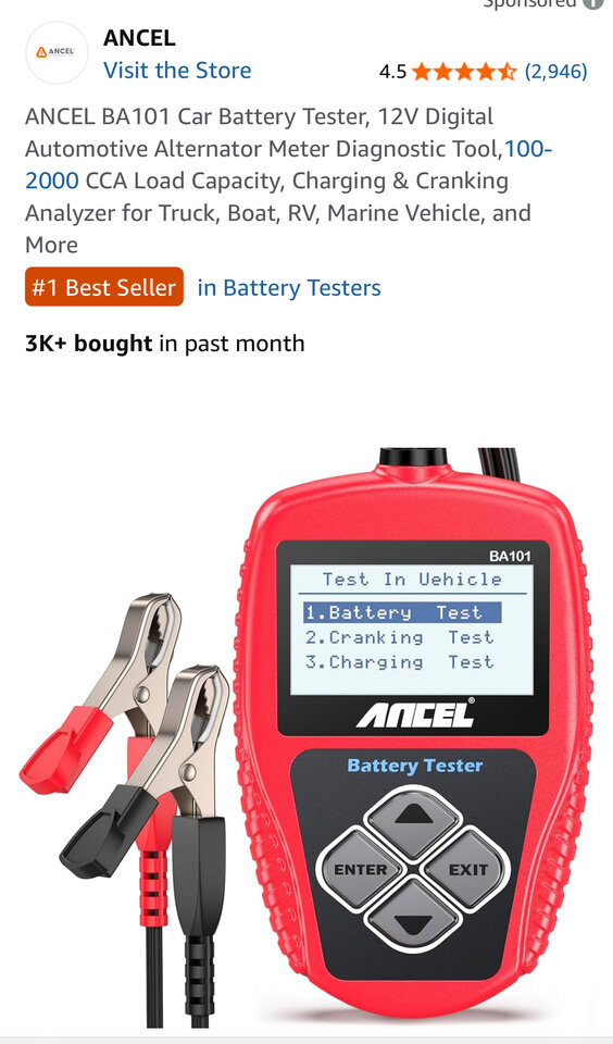

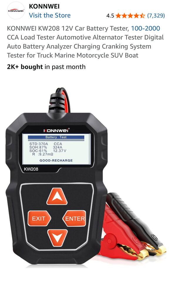

    While no guarantee your battery is at fault, having a battery tester available can help.
    This is the one I have, it has a 40% coupon on Amazon making it $16 which is a deal. I find it to work well.
    The following unit is the number 1 seller and was the winner on Project Farm's testing video yesterday. It is $37. The previous unit tested just as well in the important areas.

    I just ordered m own $17 battery tester. Thanks for the suggestion!
