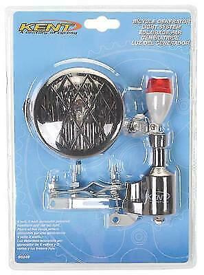

    Buy a generator and light kit for his bicycle. He can see the difference between the generator engaged and not engaged. It takes extra energy to pedal the bike with the generator engaged and it slows the bike down if you stop pedaling.
