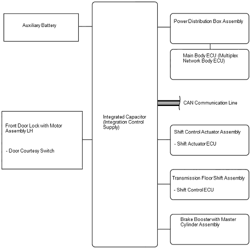

  9. ChapmanF
    28,725
    19,025
    Looks to me more like a return of gen 2's brake backup power supply, only now feeding some other stuff besides the brake actuator.
    The gen 2 thing was a box of capacitors and a DC/DC converter that could take incoming 12 VDC and boost it to store a bunch of energy in the caps. Then, in the event of a 12-volt system failure, it could dole out the stored energy at 12 volts again for however long it was meant to hold up.
    That approach of boost-converting input voltage to charge a big capacitance, and then buck-convert it out at the right voltage later, would make it sort of a cousin of the capacitor-based jump boxes you've been able to buy for several years or so.
    Judging by the selection of live data it can give you, it's a fairly involved piece of kit:

    I got that info from somebody's copy of the Repair Manual, which isn't where you find the detailed explanations of what things are for and why and how they do it; those details are in the New Car Features manual, which the Repair Manual just assumes you've already read so you already know.
    I wasn't quite curious enough to re-up my own TIS subscription and look this thing up in NCF, but I'm almost curious enough, and if someone else looks it up I'll definitely be interested in those details.
