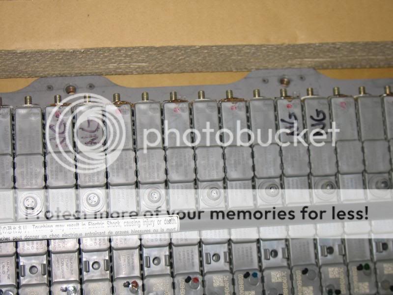

    Here's the story on the voltages. 2 cells were below the specs. They were able to charge one up again, but the other wouldn't hold more than about 15.56 volts. Apparently the specs call for about 17.
    The ODB2 codes on my bill say P3006, 3016, and 3020
    I was charged for a battery - $2985.13 and a Junction Block Kit - $149.18

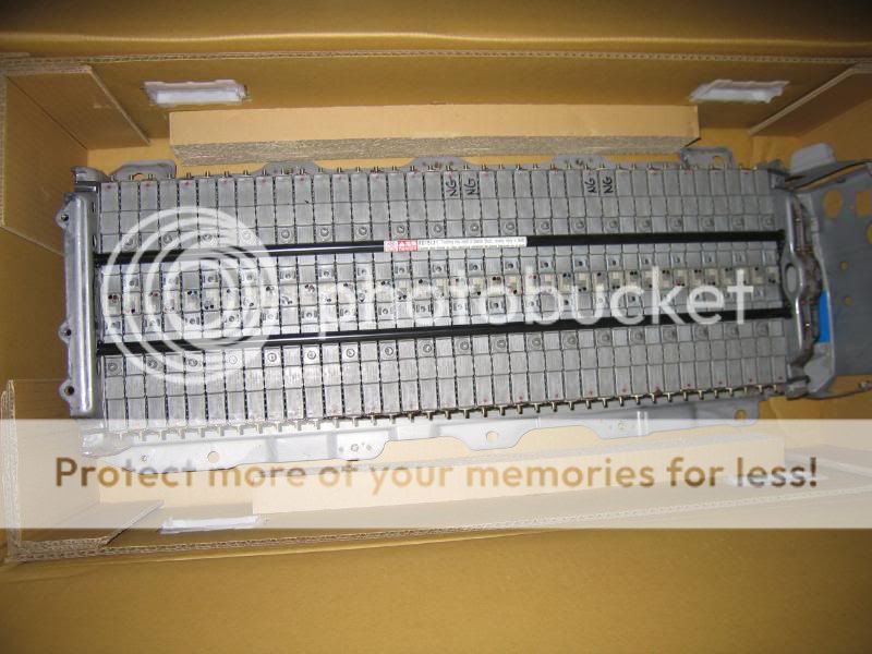

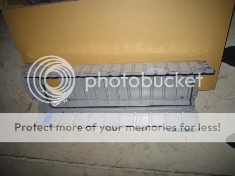

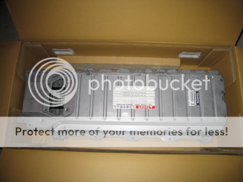

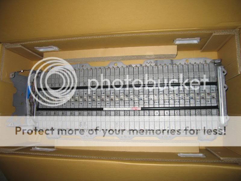

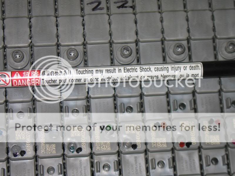

    The old battery wouldn't quite fit in the trunk, so I loaded it into the back seat. Ever wonder what your Hybrid battery looks like?
    It looks like they've marked the bad cells:

    Those are really great pics. Only 2 bad cells (I assume NG means no good) will take the whole battery down?

    Hey!! Lookit all the Elmer's Glue on the positive terminals!! SSC 40G!!
    This next comment may not make me any friends but.... I am so glad they didn't sell too many of the Gen 1 Prii.... I hated that campaign.
    For those of you who might not be familiar with it, 40G was to correct for electrolyte leakage inside the battery case. The trail of corrosion would allow tiny amounts of voltage to "leak" to the case causing warning lights galore.
    The Fix: replace the bus bars, add a little black (please pardon the term) "MaxiPad" under the positive terminals and squirt a white Elmer's Glue like substance into the tiny opening on top of each positive terminal and then dry it with a hairdryer.:rolleyes: No kidding... I still have an old hairdryer in my tool box....
    BTW I did have to replace an HV battery that had had the 40G done 18 months before. The positive terminals were all nicely sealed. The negative terminals were now leaking.
