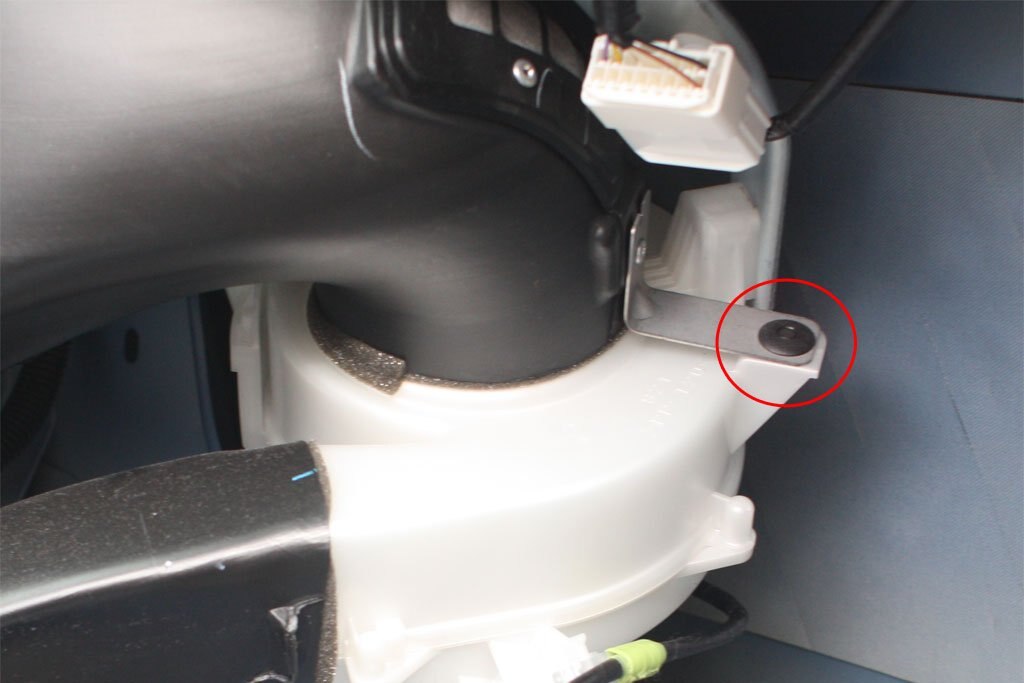

    Not that one. If you take out the plastic panel on the rear right side, the one just above and towards the front of the 12v. It should be suspended about 16 inches above and to the left of the 12v battery.
    Here is an image of the white connector just above the circled black popup retainer :
    Here is a link that should help take apart the rear hatch area on the passenger side, where you will be able to clean the HV fan and check/clean the above white connector. 2004 – 2009 Toyota Prius Plug-and-Play Car Harness Installation Instructions | Hybrid Automotive
    You don't need to follow all of the linked steps (no need to remove the rear seat, or the drivers side plastic panel, etc). You may want to take care of cleaning the HV fan as mentioned in step #23 if the HV fan cleanliness is unknown. Guessing you will do steps 1 through 5, then steps 7 and 8, but on the passenger side.
