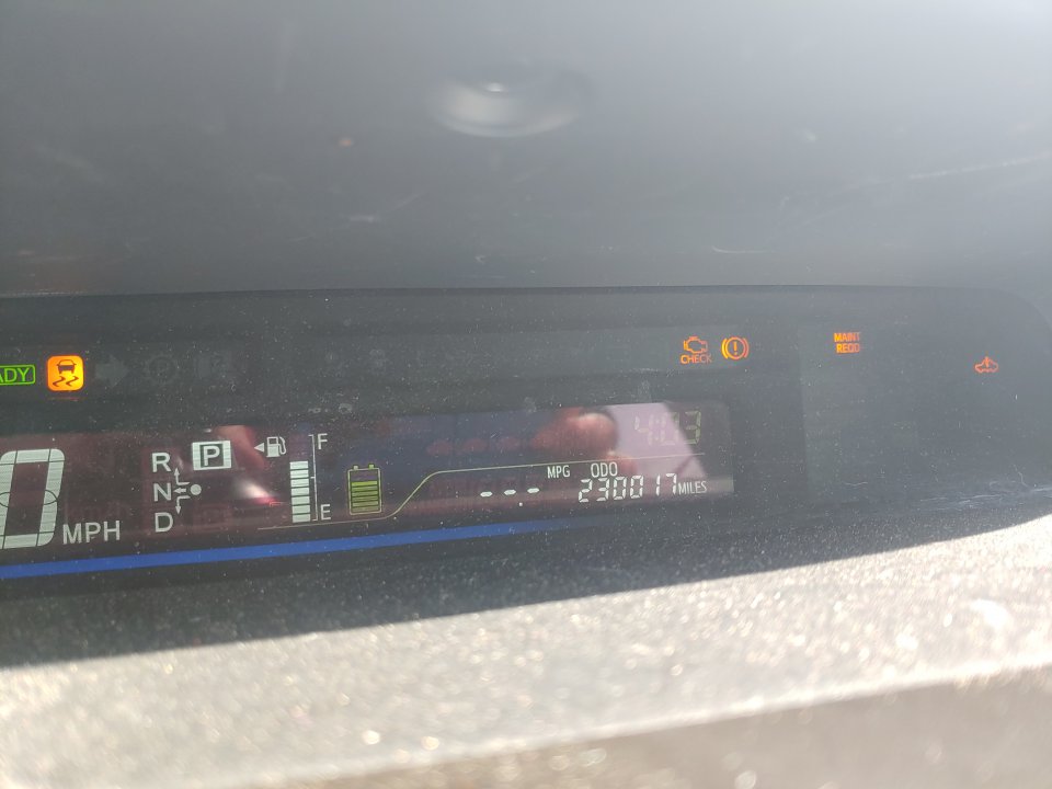

    This is my first post so bear with me. My Prius has been glitching for about 1 1/2 years. At first one of the hybrid warning lights came on, but car ran fine. The light stayed on with no adverse affect so I drove like normal. About 1000 miles later after getting gas a whole Christmas tree of warning lights lit up. The car wouldn't run or go into D. I had it towed to dealer. They couldn't get any codes that explained the issue and when they cleared the computer they could not get the warning lights to come back on. So they gave me the car back and basically shrugged. I drove the car fur thousands of miles before any issues again. This time I was highway driving from DC to DE when the Christmas tree lit up again ave the vehicle went into what I later learned was "limp mode". After sitting befuddled and hoping for a miracle, i "limped" about 4 miles to the nearest dealer in MD. It was after 5 so they could not check car until the AM. At around 9am I got a call at the motel from the dealer. They told me that when they went out to pull the car in to start diagnostic there were no warning lights and car ran normally, so they could not check anything else for me so I should come get car. They did not charge me. This was last spring and the start of the ongoing saga. I continued to drive the car as it ran beautifully. Over 200kmi and still getting over 40mpg. However, occasionally it would glitch into limp mode with various warning lights coming on. But I learned that if I pulled over and waited a few minutes, I could restart the car and it would run fine. Sometimes I would have to repeat this process once or twice down the road, but it would always work itself out. However, upon returning to functionality, 2 warning lights stay on. And, sometimes the cruiser control and power/eco buttons don't respond. But Sometimes they do! I do outside sales and deliver packages for Amazon in this car, so I do a lot of driving.

    Sorry for the long tale. I've included to pics of the dashboard lights.
    Update:eek:nly code dealer gets is p0a90 which they say calls for transaxle replacement $5k
