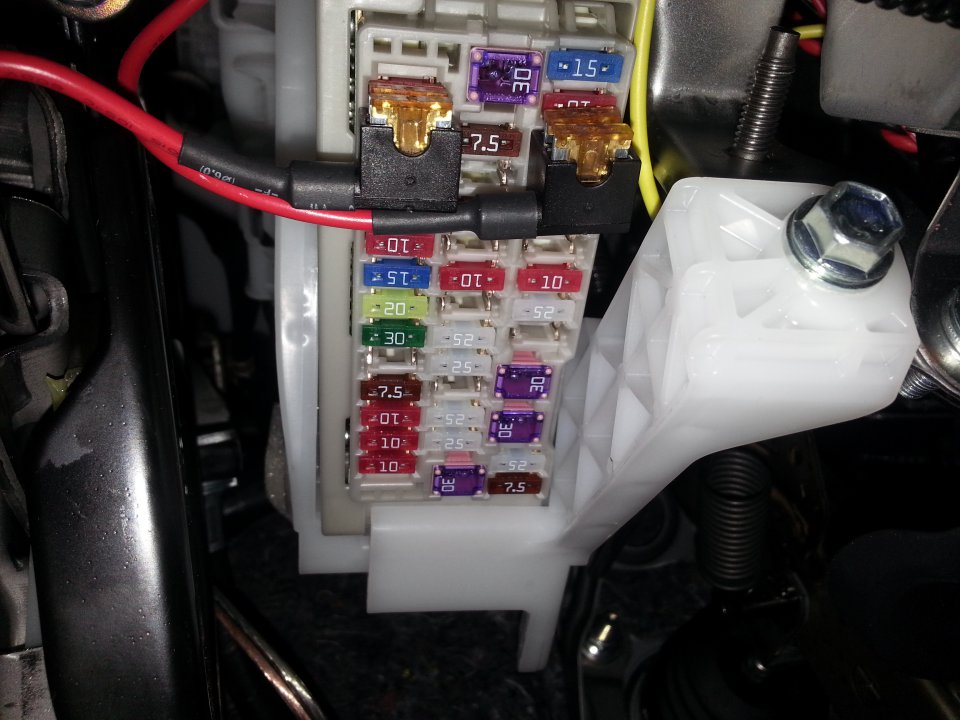

    This one is pretty easy to install, just add a Tap-a-fuse to one of those fuse that uses ACC line detections.
    This mod takes about 30mins to 45mins max.

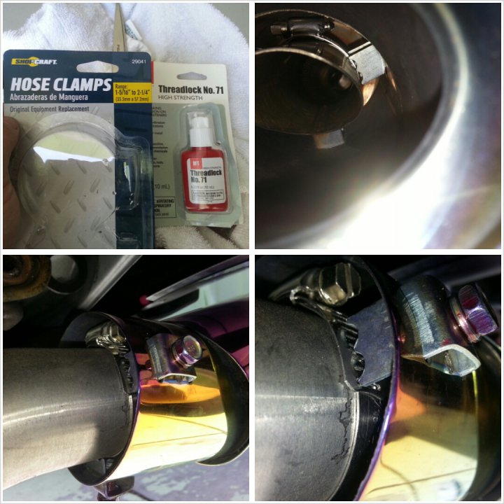

    Where did you get the exhaust tip? I'm wondering if it comes in other colors and instead of screws, it hugs the whole circumference of the tail pipe.
  11. NoMoreNow
    NoMoreNow Member
    May 13, 2013
    167
    102
    SF Bay Area
    I got mine from ebay exhaust from eastar4 | eBay
    (I like this seller ships out fast by ePacket)
    There not many colors to choose from, The one I'm using is the only one I liked from ebay store(s).
    This seller only have "Single bolt installation" exhaust tip, but is straight tip.
    Here is my close-up installation, been awhile now, looks like is holding-up.

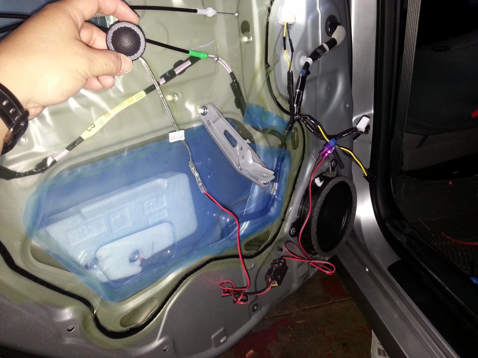

    can you elaborate on the tweeter install? Did you put them in the front, back or both? Also how did you wire them up?
    Thanks
  17. NoMoreNow
    NoMoreNow Member
    May 13, 2013
    167
    102
    SF Bay Area
    I installed on the rear doors, the highs was missing and rear speakers was too low. By adding the Infinity Tweeters same location as JBL OEM tweeter now it sounds way better (more alive).
    I like the Infinity 1031t due can be multi-mount (anyway you want) and has great reviews from Amazon.com
    Installs: was simple, remove the door panels, then used the template inside the box.
    Then use a Dremel cut out the circle, then use the Adjustable mount to the panel.
    Wiring: I just T-tap off from the rear speaker wire harness, then secured using plastic-ties.
    Note: Is been awhile since install, I have no problems with ohms, distortions, statics, & pops.
    Enjoying every minutes when I get a chance to drive it.
