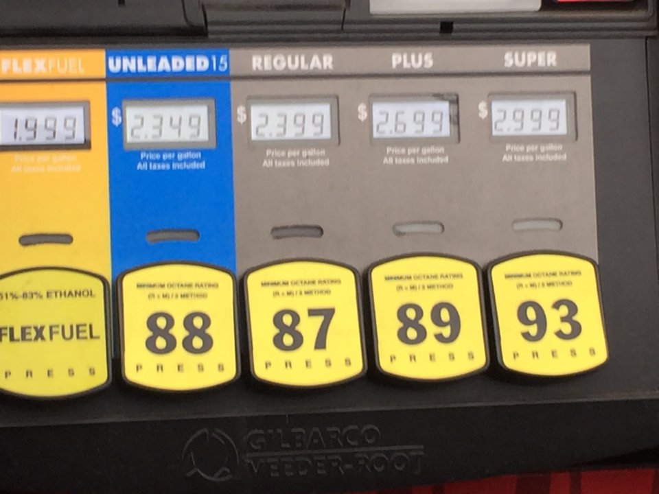

  19. fuzzy1
    17,943
    10,722
    87 - 89 - 91 - 93 is Octane rating. All are safe, though 87 is what you should use.
    E85 - E15 - E10 - E0 is Ethanol content. E85 is a NO-NO, just as the red slash says on the gas cap.
    Here is a pump image from someone else recently, from post #47 of this thread. While 87 is best for your car, any of the four on the right, in gray or blue, are acceptable. The one on the left, in yellow, 85 or otherwise, is NOT acceptable:
    The blue one, labeled Octane 88, is also E15. The gray ones are usually E10, though sometimes can be E0.
    #79 fuzzy1, Sep 2, 2018
    jerrymildred and Salamander_King like this.
