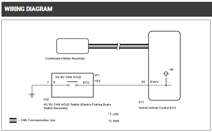

    So it's not a separate button in any sense of the word. The whole parking brake switch assembly is one unit.
    (plummets down the rabbit hole and pays for access to US and EU tech sites)
    Still can't give a solid answer.
    Things I know:
    1. No wiring changes from 2025 to 2026
    2. There is only one wire involved (labeled EVHV)
    3. The hybrid ECU changed part numbers from MY25 to MY26
    4. US MY26(w/o charge mode) and EU MY26(w/ charge mode) still use the same hybrid ECU (so the change isn't hardwired in the ECU)
    5. The switch assembly has a new part number (but that could be just because of the printing on the switch)
    6. The new version of the switch assembly is 13% cheaper than the old version
    So there are two scenarios:
    1. The change is software-based and done when the hybrid ECU is initially programmed(why US and EU ECU's are still the same)
    2. The old switch is different internally and sends a special signal when it's been pressed and held
    It will cost someone with a 2026 US PHEV about $110 to test. They'd have to buy the old version of the switch assembly and see what happens. The install is fairly easy. The piano black portion of the center console needs to be popped up to access the four 10mm or philips screws that hold the switch assembly to the trim from below. With a small ratchet or stubby screwdriver, a person might not even have to fully remove the trim section(it includes the cup holders and storage tray). Four screws and one electrical connector and the job's done. Maybe 5-10min for a trained tech; 15-30min for a novice. For testing purposes, a person wouldn't even have to remove the old switch; just pull up the trim enough to unplug the old one and temporarily plug in the new.
    These are the three versions of the switch assembly:
    84390-47110 - HEV, 2023-onward
    84390-47110 - PHEV, 2023-2025 US, 2023-onward EU (w/ charge labeling) - $215.55 MSRP, $149.03 today, $111.78 during 25%-off sale
    84390-47140 - PHEV, 2026-onward US (w/o charge labeling)
    I'm going to guess 60/40 nothing happens if a 2026 owner swaps to the older switch. I lean toward KMO being correct and the change is in the ECU programming. But the drop in the switch price and the fact that the US and EU hybrid ECUs are still the same part number means a physical change to the switch is still in play.
    Besides a '26 owner buying(or borrowing) an old switch to test, another way to know for certain would be to attach an oscilloscope or other advanced reader to the wire* on a 2023-25 PHEV model(while everything's plugged in and the car's running) and see if there's a signal difference when the button is held for the needed amount of time. Does the button send two distinctly different signals, or is it just a single continuous signal for as long as the button is pressed?
    But I don't have the tools or the car to do the testing, so that will be up to one of you guys if you really want to know.
    *probably pin 6(blue - EVHV), but possibly pin 3(gray - EVMS - EV Mode Select)

    Did you mean you paid for both? You can access the US and Japanese parts databases from the EU site - not sure about other manuals.
    There's a third scenario which is that the hybrid ECU is getting "permission" for charge mode from something else in the system - a message from another ECU, or just a line being tied high or low.
    Which could then be modified into a fourth scenario (or at least a variant of the second), which is that the button is indeed electrically different, but without being smart about timing itself. Maybe the non-charge and and charge buttons simply have different resistances when pressed.
    So maybe the new ECU will enter charge mode if it sees a 220ohm circuit closure for 2 seconds, but not if it sees a 780ohm closure for 2 seconds.
    (Or it could be a different resistance when not pressed.)
    That's far more likely than a smart button, and given the information that there's a new ECU but both EU and USA are the same, I'm going to revise up my estimate of the odds that a button change could be sufficient - could easily be Hammersmith's 40%, or higher.
    Mind you, at $200 per button, you could afford quite a lot of smarts...
    Copy and paste error on the part number - same as what you listed for the PHEV.

    It occurred to me that the service manuals might give a clue here. The EU one says, in "Hybrid / Battery Control > Combination Switch > Inspection", that for the EV/HV Hold Charge switch, resistance should be below 50 Ohm when pressed, above 10 kOhm when released (between K22 pins 6 and 7 for LHD; 7 is earth and pin 3 mentioned above is the Auto EV/HV switch).
    There's no indication in the EU manual about the possible omission of Charge mode though - it assumes it's there.
    Maybe the same section in the US manual might indicate different resistances for the other button type.
    Wiring diagram in "Hybrid Control System (For PHEV Model) > Pattern Select Switch EV/HV Mode Circuit" reinforces that complete circuit is button <-> Hybrid Control System <-> Combination Meter Assembly.
    Do we think the Combination Meter Assembly has any part in the decision making here, or is it just displaying state? Who manages the Auto/HV switching for Predictive EV Drive (outside the US)?
    Switch assembly has 4 wires going to the hybrid control ECU, for Drive Mode +/-, HV/EV and Auto EV. The rest go to the skid control ECU.
    If it was just the button, then the permission would have to be encoded in those 4 wires somehow. Conceivably (but oddly) it could be one of the other 3 wires. Manual says the same thing for the Auto EV button - 50 Ohm pressed, 10 kOhm released. But the inspection values for the pair of Drive mode wires seems to be missing.
    An obvious test, which doesn't require actually buying a new button, would be to just short the "ECU<->EVHV" line to ground for a couple of seconds. Will that make a new US PHEV go into Charge state?
    #12 KMO, Jun 7, 2026
