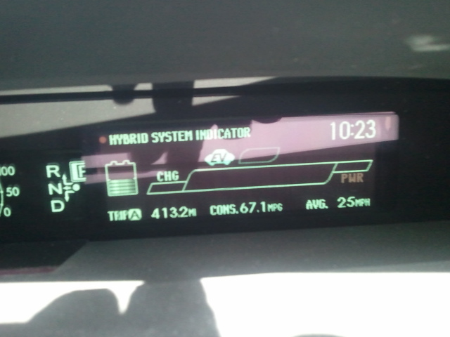

    This is my current dashboard with a 25% freeway/75% urban-suburban mix.
