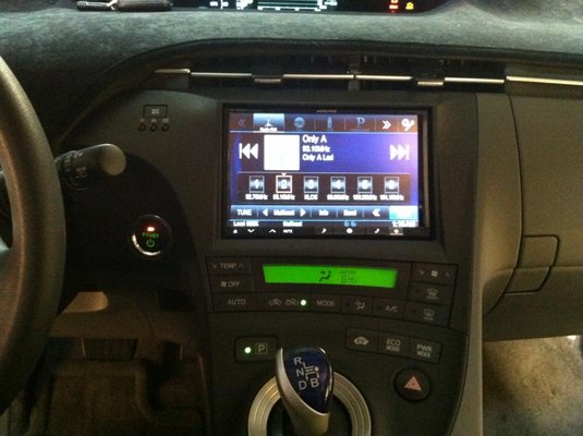

    I most likely won't have pictures or reviews of this system until Feb 2014 since I will also have to save a few hundred dollars for the high quality installation job at a shop. Can't wait to have great music and navigation in the car (see pict for example of identical dash kit and 8 inch Alpine head unit)

    I have the Alpine headunit and it works well. I have a periodic issue with the GPS where it wont be able to see the satellites and I resolve the issue by resetting the unit. I keep a paperclip in the glovebox for this purpose.
    I get one of the early units, installed Nov 2012 and the original firmware only allowed you to call a favorite phone number that was pre-programmed. The phone keypad and phone book were only accessible if you were in the setup mode, handbrake on and the car in park.
    A later firmware release allowed you to access the phone keypad and your phone book.
    You will lose all the car display functions that were available on the factory radio. I didn't see this as a big loss since this info was available on the display. The Alpine steering wheel control module does not integrate the phone buttons on the steering wheel. You will need to pick up calls by clicking on the radio display.
    As for sound quality, I can't compare since like you I replaced all the speakers and installed a amp to run derive the speakers. I went with Hertz Energy speakers and a Hertz 4 channel amp. The system sounds awesome.

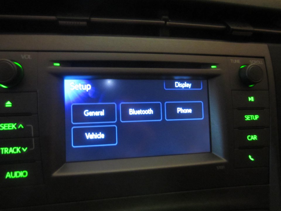

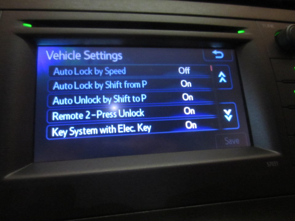

    Appreciate the reply! Regarding loss of consumption data on the viewscreen, are the vehicle settings options going to not be accessible once the new head unit is in as well? (see attached photos)
    If I can't access these options anymore, it doesn't matter but I do hope that the "brain" of the car can remember these settings in the event of a dead battery. I wonder if when the battery in the trunk is disconnected, the vehicle settings revert back to default?
    Any ideas? Thanks again.

    None of these options are accessible with the Alpine. I can't comment if the vehicle will retain the settings if battery goes dead. In the worse case scenario, you could reconnect the factory radio to change the settings. The Alpine Perfect-fit kit comes with a harness so the installer should not have to cut the factory harness to connect the new radio.
