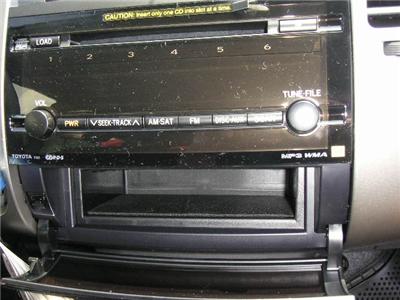

  10. Flying White Dutchman
    Dec 29, 2007
    4,376
    313
    well i want it to be placed somewhere people can not see it when they want to break into my car ;-)
    no i always have to take the lilliput screen out ot fthe car with me when i park it somewhere.
    but first i hope to get a 2x16 or 4x20 lcd screen working on the duinomite ( stil not recieved it )
    i want to place it right here.
    behind the dark glass plastic cover
    it would be a nice hidden finisch with some buttons on the side to switch phev.
  11. lopezjm2001
    lopezjm2001 Senior Member
    Apr 14, 2009
    1,146
    407
    Sydney Australia
    I guess it may look something like having a ScangaugeII installed in this cavity being much smaller than a 7" LCD screen.

  14. Flying White Dutchman
    Dec 29, 2007
    4,376
    313
    yes only the scangauge got a nice housing haha this is the bare lcd screen with board.n
    its a lot cheaper then a touch lcd screen its easy to hide and it wil give some basic info like voltage amps and if your in PHEV or normal mode.
    a switch beside it for phev mode and for DTC reset and basic functions are there for a nice setup i hope.
