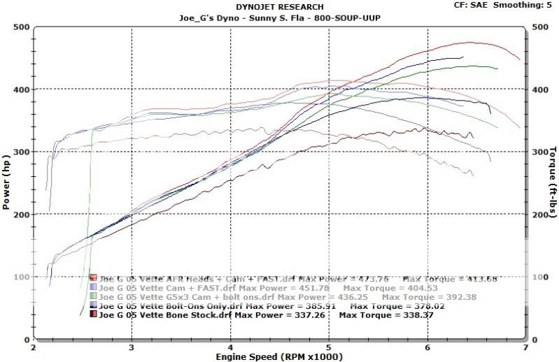

    Actually the Vette weighs the same as the Prius. I know the results of low rolling resistance tires though, when I go racing I install super skinny front tires (GTO temp spares) and I gain a a tenth just from that change alone. And I'm very familiar with engines, I swapped cam and heads (did the head swap myself in my garage, I used to be a mechanic in college so I know how to do these things) to raise my power for racing. The Vette was 12.99@108 stock, now it's 10.81@128. Still gets 21 mpg 70/30 hwy/city which is fantastic for the performance level IMHO. Yes I have records of all fillups to prove it. :)
    If you're interested, I overlaid all my mods on one dyno sheet, it's very clear headers affected the entire power band, but the cam, aftermarket intake, then aftermarket heads (in that order) generally only affected the upper RPM band above 4500.
