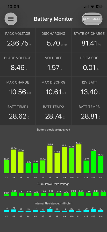

    On the "Battery Monitor" page, the red circle, item #10:

    Thanks for posting that
    It seems that functionality is only available on Android. What a shaft!
