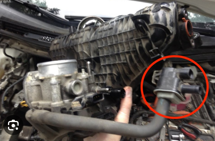

    Gen 3 evap system, no bladder:
  6. Mendel Leisk
    60,276
    41,473
    "Purge VSV" looks to be that little black box gizmo mounted on underside of intake manifold, incoming hose from gas tank, outgoing hose to spigot at 6 o'clock of the circular base of intake manifold, just below throttle body.
