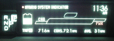

  18. fuzzy1
    17,715
    10,452
    Not at all, it is easily done under the right circumstances. Though that means not in common heavy traffic. This is from one of my very old posts:
    "I'm also amazed at what it can do even on hills. This one was a round trip, a mere month into hybrid ownership. Zero net climb, but 3000+ feet gross climb and even some downhill engine braking. But only a handful of stops:
    Since then, a few round trip commutes half that distance with more stops, a couple thousand feet gross climb, and a ten hour engine cooling stop in the middle, have reached 76 mpg. Unfortunately, no pics."
    I've also done these, but they fell into the "coming down from Mt. Everest" category:
    The more skilled folks, with time to spare outside of traffic, can do these on level roads.
