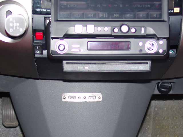

    I just got done installing a car2pc in my car for my PC. :D
    So far the thing works great. I can now use the steering wheel to move to the next track. Holding in the Mode button to turn off the radio does turn off the radio but it also pauses winamp which can be a good thing sometimes. The only thing that does not work that I know if is text on the MFD. But I don't care about that. Also it says you must be on CD changer for it to work. Well when you go through the different modes it will not say CD changer. It actuall wont say anything but it will still work. For an example when you press the mode button you cycle through AM, FM1, FM2, (this is blank), AUX, and repeat. The blank spot is the CD changer or the car2pc device.
    The device fit nicely in front of the large wire block behind the dash. Its located between the radio and the glove box.
    The reason that I bought the car2pc is because the way I have the CAN-View and car PC setup. If I'm viewing the CAN-View and want to change the song I have to switch to the PC. Then when I go back to the CAN-View the CAN-View will not recognize touches. So my solution was the car2pc. Now I can leave it on the CAN-View screen and change songs with the steering wheel. It also makes it safer since I don't have to look down at the screen to find the next song button.
    I think my car PC is complete now. I cant think of anything else I want to do to it at the moment.
