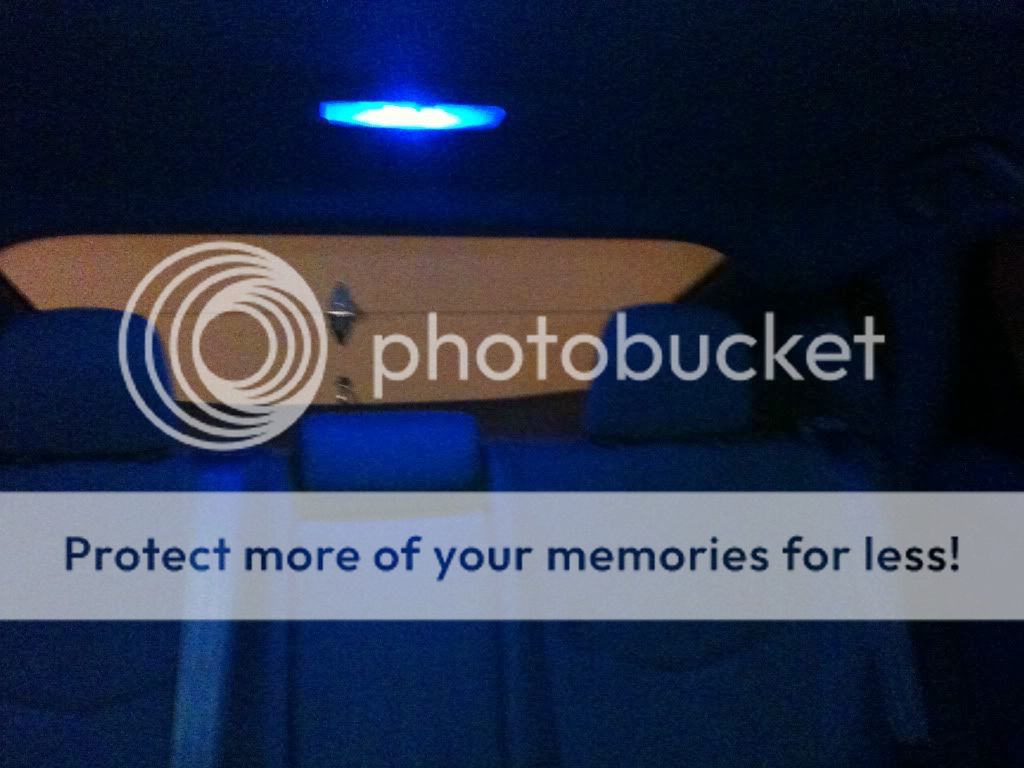

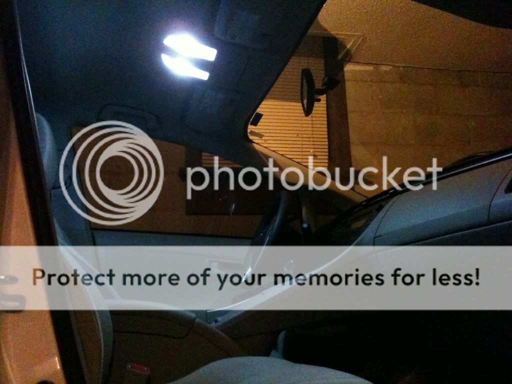

    Thanks for the comments Paulieprius! It's not a difficult mod to do, nor does it involve a lot of time and money. I think it's a great way to spruce up your vehicle for little cash. I'll post up some more pictures once I get the blue LED's installed in the doors. Now THAT is gonna be cool. :cool:

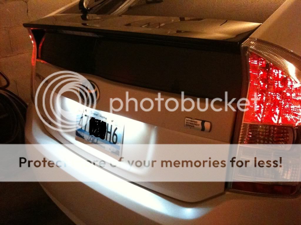

    Okay so how do we replace the license plate lights? I heard that's the hardest to do.

    On the old Prius, yes but the new one has little removeable access panels that make the job easier.
    Just locate the two access panels on the inside of the hatch (so in the big black plastic cover), unplug the socket then twist the socket out of its holder and there's the bulb + socket. Replace bulb and reverse process.

    Replaced map lights and license plate light. I took the door light out too just to see if the same bulb fits and it does. Door lights were only tricky with getting the bulbs out, but once you get it, you'll have no problems.

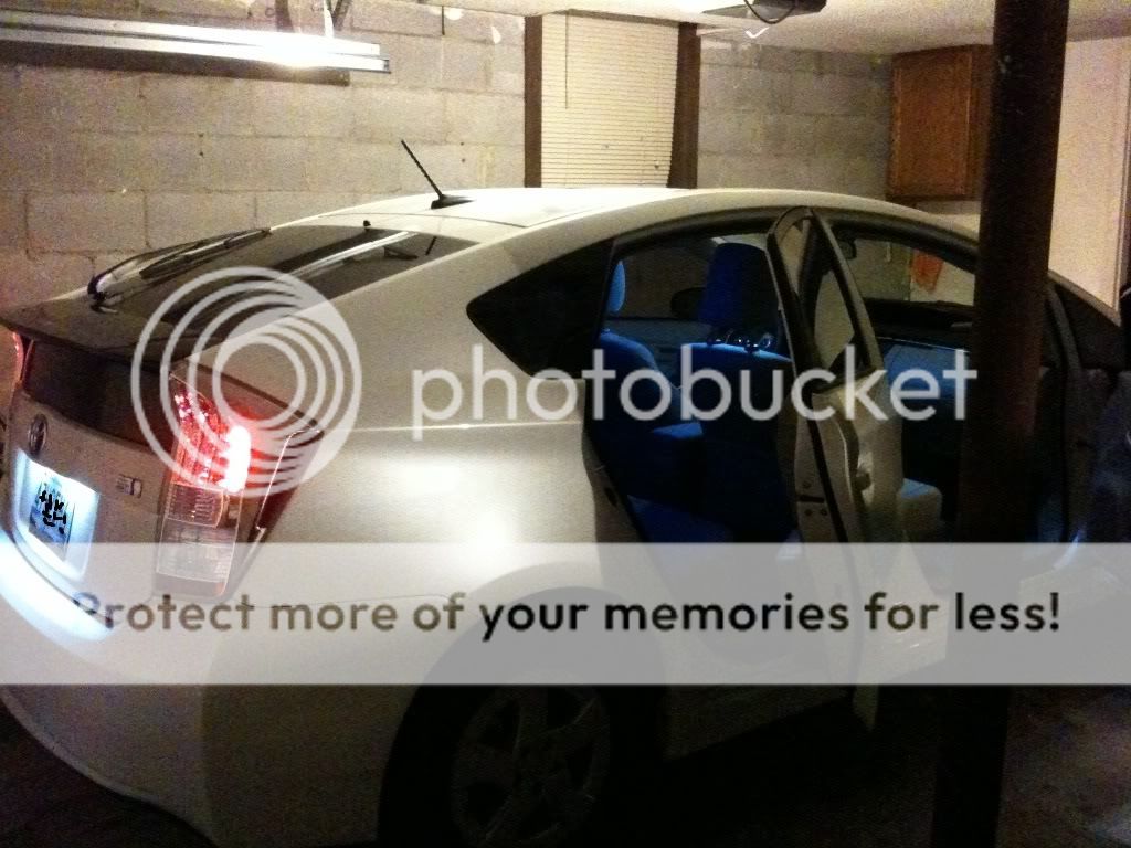

    Heres my interior an exterior FINALLY completed. Map lights, vanity mirror lights, dome light, door lights, trunk light, reverse lights, turn signals, sidemarkers, parking lights, and hid headlights. All the bulbs were off superbrightleds except for the HID kit. I believe the brand for that is Halo. They are 6000k. Heres my pics.

    SuperbrightLEDs is awesome. Found this post last Thursday, ordered the lights, they showed up today and Map, Dome and License all done. I need to order the door lights now too. It looks so much better, thanks for the tip.:D

    Thanks for the pics. I see that you chose blue for the map lights and dome light. Is it bright enough? Any regrets. Looks cool!

    Hey there- I used the same LED bulbs as the map lights. WLED - BHP5 (The B stands for blue)
