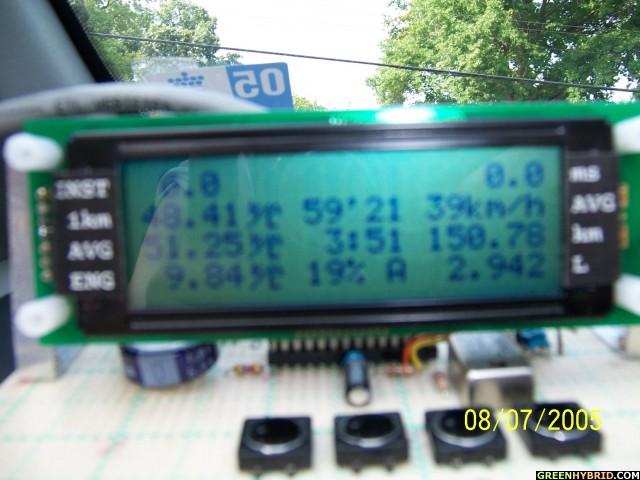

    <div class='quotetop'>QUOTE(sub3marathonman @ Mar 12 2007, 01:12 PM) [snapback]404018[/snapback]</div>
    The best shift of the famous 109 mpg 1400 mile marathon run recorded 9.84 km/L (23.1 mpg) for engin on mileage (pulse or acceleration part) and 19% engine on distance, so they glided the rest, 81% distance.
    The result of the shift was 51.25 km/L (120.6 mpg) for 150.78 km (93.7 mile) distance.
    http://www.greenhybrid.com/discuss/showpos...mp;postcount=77
