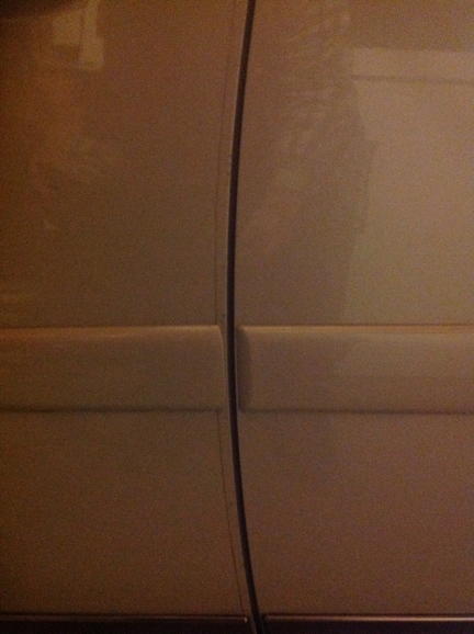

    Hi Dave
    You asked me to explain about the gap left in the back of the front door for the door edge guard. I thought that a photo would be the clearest way even if it is after dark here and my garage light is not the best. Clearly the gap between the front door section and the rear door section of the BSM could be tighter without the setback for the door edge guard.
    I am trying to be helpful, but I am afraid that it is only confusing. This is not a big deal.
    Allan

    Allan,
    To the contrary, you are being VERY helpful. This picture 'IS' worth a bunch of words! :ROFLMAO:
    And I can see that your door edge guards necessitated the gap, which is not bad at all.
    Sorry to ask more info ;) but are your door edge guards clear or white? Are they Prius specific, or just generic from the local auto parts store. I too like the idea of 'extra' protection, so want to consider this door edge guard idea too (with wife's OK of course ;) ).

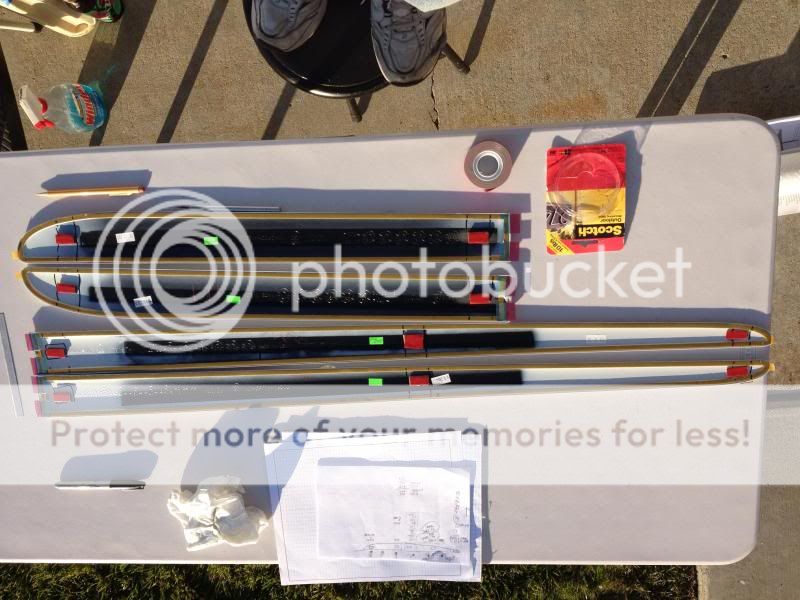

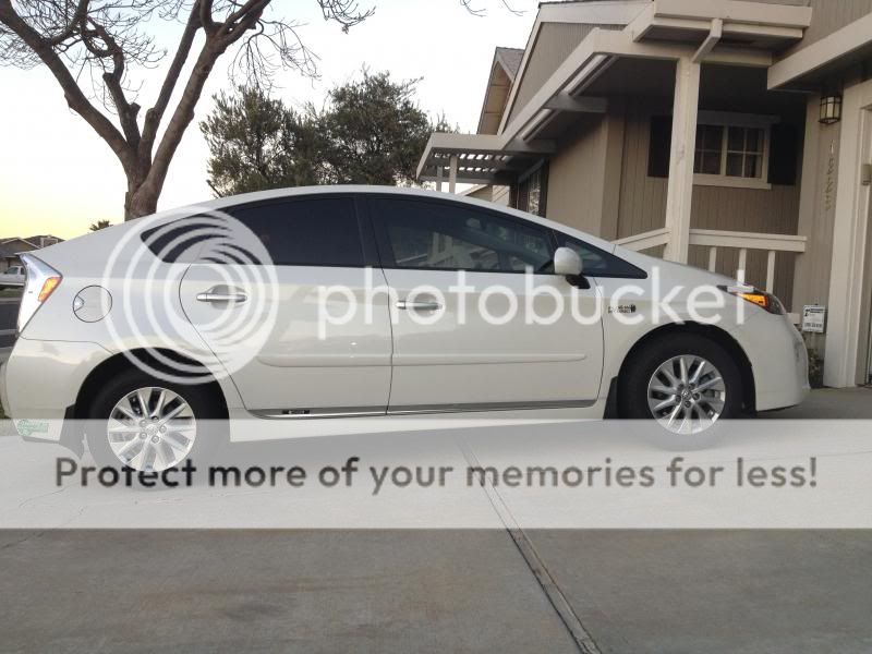

    I finally got to install mine last night, along with the second lower door molding.
    How I did it:
    I decided to raise my 'top line' measurement* from Allen's 10" back, 8.5" front to 10.875" back, 9.25" front. This was to cover an existing door ding in the clear coat. These measurements are from the upper edge of the of the silver lower door molding I had just added. If you do not have these moldings, measure from the crease in the door which is ≈ 1/4" higher, and subtract 1/4" from your desired thread or strike line height. I found using dark thread held with painters tape was very useful since I was able to move it easily and it was a one man job to place. I just tied a few knots in the end and made a loop for the tape to have more to grab/hold. Allen's 10"/8.5" both were 40% of the distance from lower trim to upper door crease above door handles. I just made sure to keep my raised amount the same % back and front. Mine turned out to be 44%. I used 3M Exterior tape for extra holding power in 5 places (2/3). I used a 1/8" piece of plastic sandwiched between two pieces of 3M tape where needed* and just used 2 to 3 thicknesses of the tape at the shallower places. Tape is ≈ .045" thick.
    Once I established my top of molding 'thread line' from my two end measurements, I placed a small piece of tape in the middle 'split' on each door at the line, because it is easy to move the thread during installation. After that was done the rest was a piece of cake.
    Excellent side benefit of Rav4 BSM... The door closing sound/feel is now solid. It no longer sounds like a hollow 50 gal. drum was banged on when I close the door (from the light door skin reverberating). SWEET! (y)
    Lower Door Moldings... We LOVE the look of these! Euro Mudflaps, black... I actually like them being black after having them installed (after thinking I 'had' to have them painted! ;) ) I think they blend well with the white/black/ silver color scheme. :cool: All is up to personal taste, of course.
    *At the end of the back molding this sandwiched adhesive was a bit too high, so I sanded off the raised p/n on the underside of the mldg there. It may have been still a hair too high, as the back tip of my molding is slightly off the door surface (but not above where the 'extra sticky' actually is, about 2" in from end :confused: )

  7. xliderider
    8,140
    3,274
    Davekro, nice job! :)
    FYI, standing on a small stool to take a pic is a good way to fall and injure yourself. :eek:
