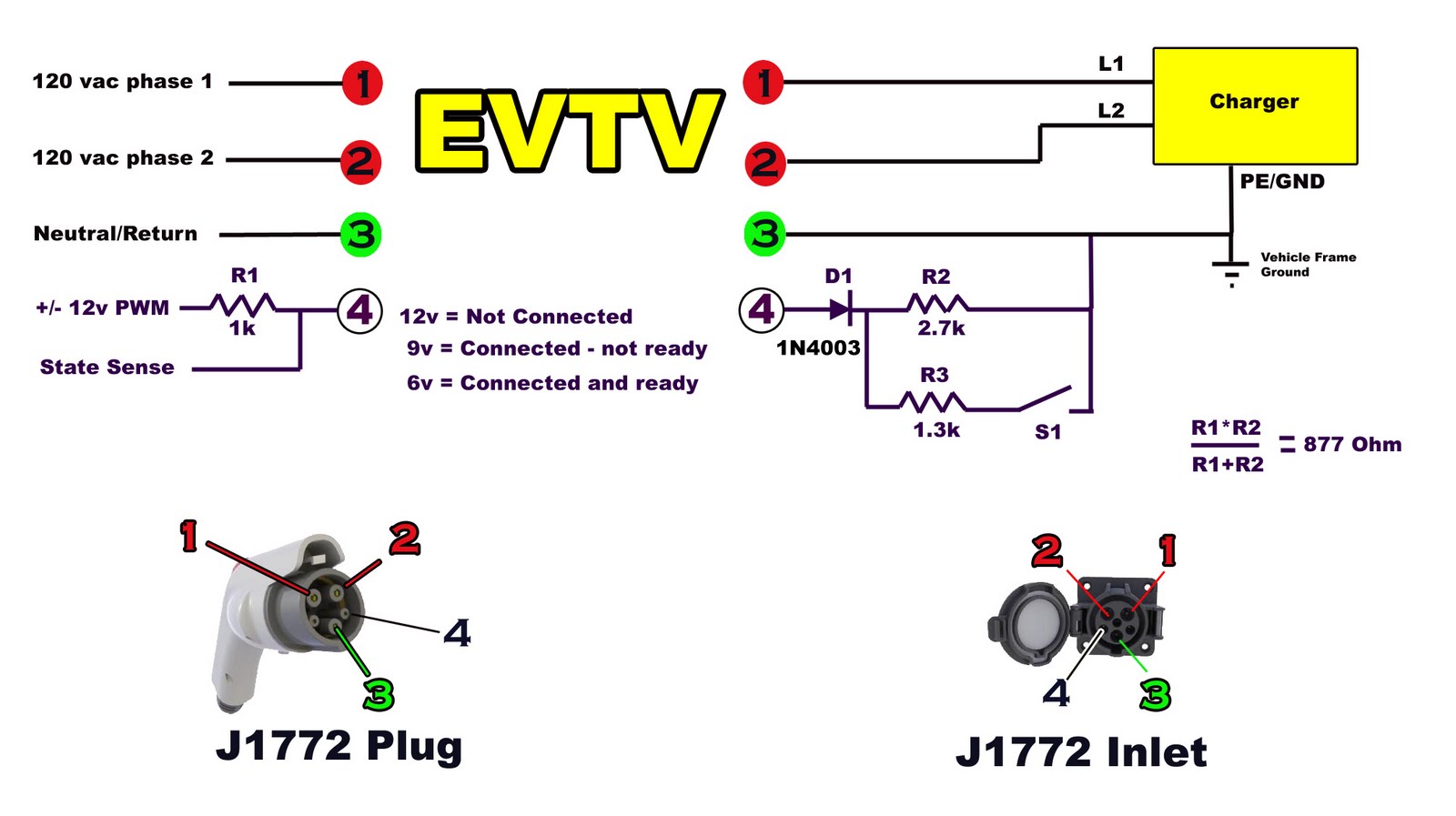

    :) Thanks Mitch. Which position on the J-1772 connector would be the Pilot signal? Or, I would assume either the Blue or Orange wire isn't connected to the J-1772?

    Found this...

    Excuse my ignorance, but I just came into this. Where does that 12V come from, is that fed from the sensor circuitry and separate from the power input, and unaffected by the size of the power input? What I am driving at is: if the power was adapted at the plug in point, that is after the brick, to 220, would the sensor circuitry be affected. It looks like that is a 12V DC level at th
    e sensor, coming from the car. I already know that I can charge at 220 at chargepoint, what I don't get is why the charge cable cannot be easily adapted to take both voltage levels. Is the electronics that complicated . ??? Thanks for the nice schematic.

    It's called an auto ranging power supply", takes 100-250VAC and outputs 12V, vehicle the OpenEVSE site, there are schematic and pictures of the power supply that Chris Howell uses.
    FYI, OpenEVSE can support either 120V or 240V, it's just supplying it to the cars onboard charger.
